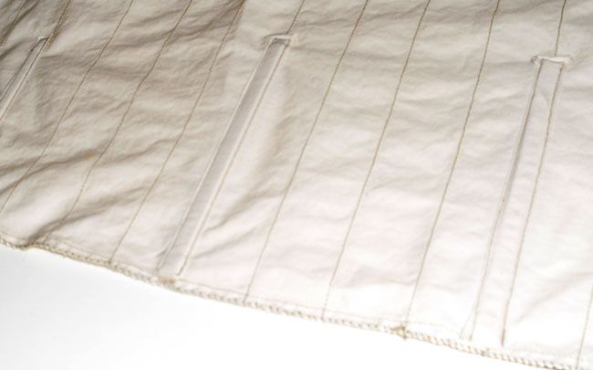

« Reply #126 on: July 24, 2014, 10:29:55 am »
I'm on another forum where a regular cry is "This thread is meaningless without pictures".
And so, without further ado:
Notes: the mizzen's set a little high here, the main and mizzen gaff outhauls aren't in place and the jib's a little low. But she has sails - albeit ones held in place with thread and blue tape.
Length 44" (112cm), height 48" (122cm).
I've the cabin roof to finish, clean up and paint the hull's sheer, a splash of paint on the cabin and that's about it. Mrs Andy just asked "How long?" I suggested twenty hours.  :embarrassed: Then it's off on an applied course of Practical RC Sailing.
That formerly bizarre-o super-rotund hull now doesn't look so bad with some height above it. Oh, and the cotoneaster has done really well this year!
