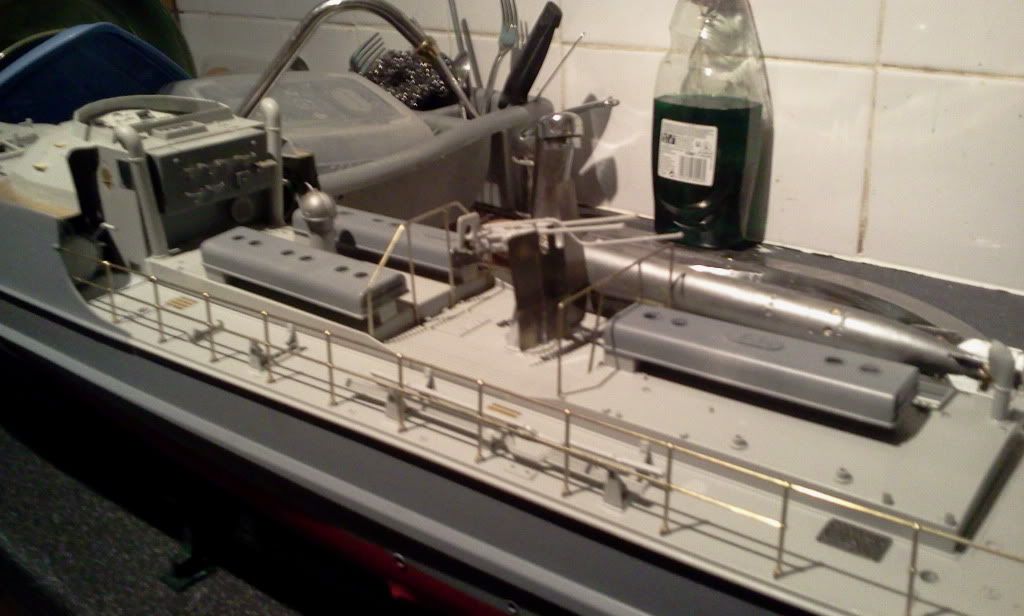

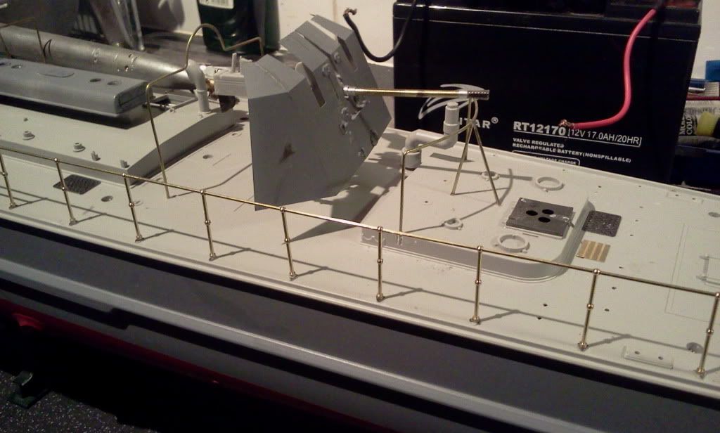

couple showing were i have changed bits to brass rather than use the plastic
the early radar some of these boats had

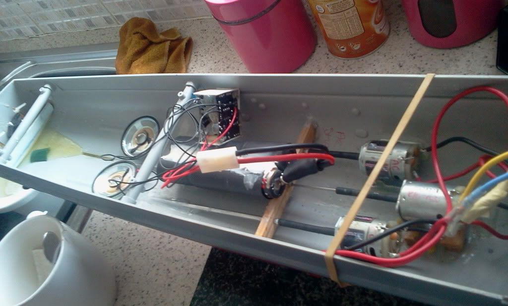

ive used the standard shaft angles which allowed me to use the p frames as supplied in the kit and also the outer skegs, andy of mmb`s kindly made my 2mm shafts, i have also used the supplied rudders and drilled them out to accept brass rod, the three rudders work using a standard servo to control the main rudder and a mini servo on a Y lead controlling the outers
i have all motors operating off one 25 amp mitronik esc

right yes those stanchions are robbe 25mm twin holes, if my vernier is to be believed the rail is 1mm, though i did have to relieve the holes on most stanchions, the other brass is the same diameter wire, what i did was copy the other bits on card and bend the wire to suit, allowing approx 2mm ends to go into the decks, all soldering was done in place on the boat using croc clips to dissapate any heat, gun barrel was turned on my unimat 1
just remembered, the rearmost stanchions need to have the tails trimmed back a bit or they foul on the hull, you will notice on the kits side rails some have secondary angled legs, not done those as yet but it will handrail wire used and angled to suit then soldered below the lower rail
i got my stanchions via ebay,

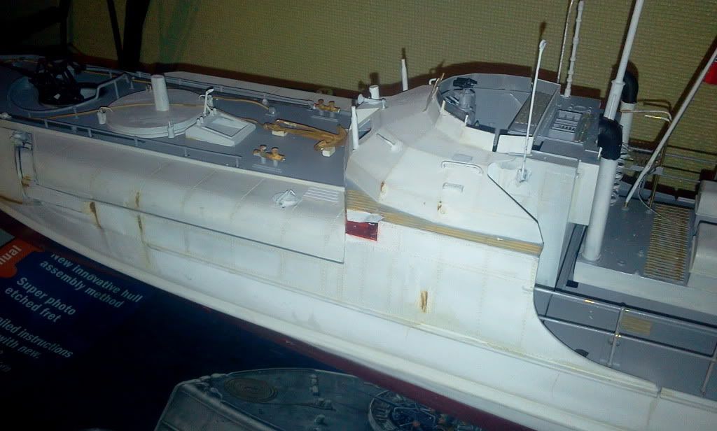

access via that mid section is poor, i cut my deck right behind the wheelhouse and have made using the mounting screws the rear deck totally removable if needed, what looks like a black line in this pic behind the wheelhouse

mine does not have gear boxes in as im using none scale graupner 25 mm three blade plastic props, 2 right hand and one left - have least stuck with how these ran
that piece of wood in the hull, my center shaft tube is shorter that the outers, found at full chat the center shaft whipped around, so i added a bush to  support the shaft and over sized holes for the outers, then bonded the lot in with 5min epoxy
