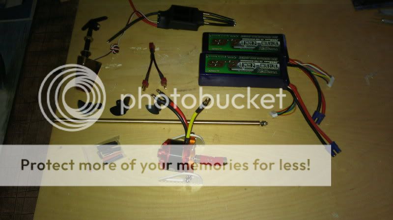

Purchased (or stole considering the price) a 36" Fibreglass Huntsman kit on Ebay a few weeks back. It cost me almost as much to post to Finland as it did to buy it but even so it was still less than half the price of a new one :).
While waiting for delivery I browsed the usual suspects looking for motors etc
And ended up with this lot
what we have in the picture is:-
200amp watercooled brushless speed controller.  Overkill? maybe but it is popular knowledge that Chinese Amps are smaller than European
2x 2650MAH 6S lipos 22.2V 35C Lipo Packs. These will be used together to give 22.2V 5300Mah
Motor C4240 Brushless outrunner 1020KV 660W 9T motor with watercooled mount
12" M4 Propshaft and 3 off 2 bladed Props 35, 40 and 45mm

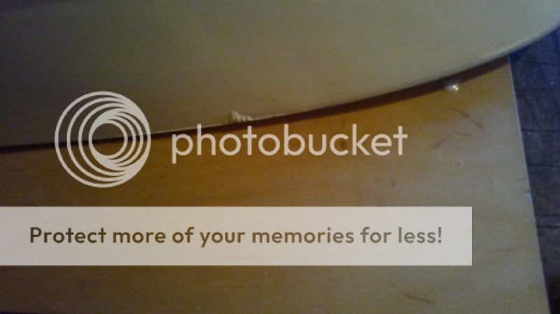

Less however can be said for the hull :(
The hull has a decided bow in the side. you can see it easily when looking at the hull but its cot so visible in the pictures.
And there are a couple of moulding flaws
Will i be ok to just sand these back and fill? I plan to paint the hull anyway as the white has yellowed a little with age.
