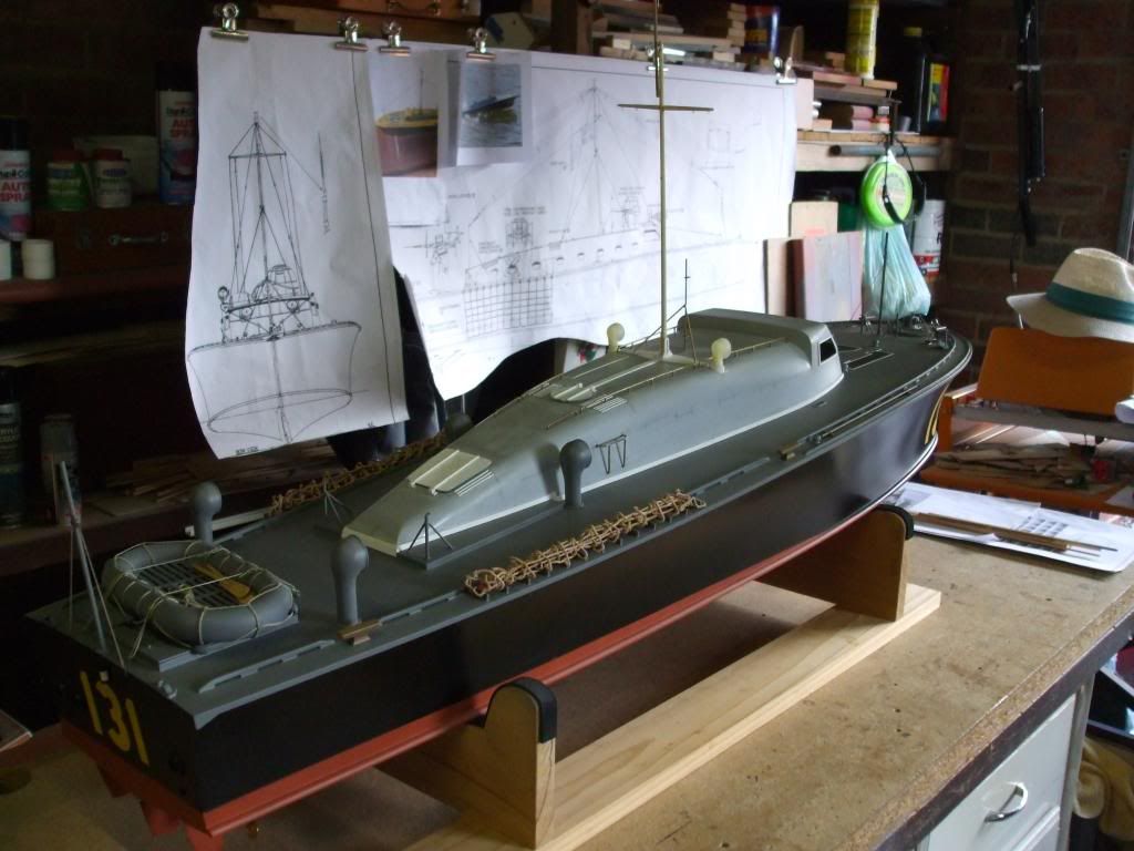

A shot of the bow working on the superstructure at the moment.
Thanks again Ken for your help.
Gra

« Reply #38 on: December 05, 2012, 09:11:21 am »
Trial run last Sunday.
Gra

Re: Whaleback 1/16 Scale.
« Reply #40 on: December 05, 2012, 10:03:01 pm »
What did you use for the scramble nets? Do they unroll?
gra2
  • Posts: 431
  • Location: Victoria Australia
« Reply #41 on: December 06, 2012, 02:35:17 am »
Hi Dave,
I used rigging twine dyed with a tea bag.I layed out the shape based on the plan with lots of nails around perimeter and tied of each
square with fine twine and a small dab of s/glue.
Net could be rolled down but i have tied it down on deck.
Graham
