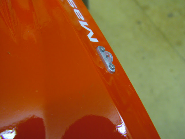

which make of deck eye did you retrofit please ? nylet? or somewhere else ? if the centres are the same it makes sense not to create more holes and i'll order half a dozen!   ok2
yes one of the two steel spreader mounts  has snapped several times and has been epoxyed back together . one spreader arm actually dropped into the silt of the pond but i got it back with a powerful magnet from a broken car radio antenna base that i keep for such events (larkshead knotted to a multi-thousand foot reel of kite string!)

I dont know if there are any commercial deck plates available that will suit the recess but I made them from a small piece of ali tee bar...
One of the more negative things with the 'fittings' I've found is that the screws, screwing direct into the un-reinforced fibre glass, can easily strip a thread and soon become very loose. I have solved this (so far that is) by epoxying a strip of hardwood beneath the deckplate areas.  It's obviously awkward to get at so I did this by threading a chord through one of the screw holes in the deck pulling it out of the hull with a piece of bent copper wire. This was passed through a hole in the reinforcement then back through a second hole with plenty to spare - these holes predrilled to match those in the hull and suitable for the screws to bite into. Another line was passed through the second hole in the deck, brought out and attached to the first - enabling the first line to be brought back through the second hole. The block was smeared with epoxy then the lines pulled tight - to bring the block up to the inside surface and in place - and then taped to the hull until the epoxy had set
Once the epoxy had cured the line was pulled through and the deckplate screwed into position - very sound - so far  ok2  - I'm keeping my fingers crossed the backstay won't need doing which might be a lot more awkward to do.
