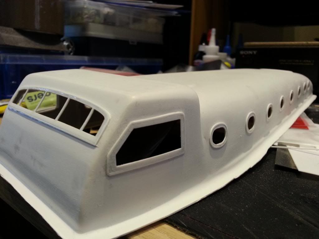

Here are my frames in use on my whaleback, after fitting the frame i added a 1/2 mm square edge round the frames, before sanding themdown slightly to add the slight lifted edge, the only thing to fit now is the little extra bit above the windows ( made from 1 mm strip ) sanded off on the corners and just adding a little lip above the window.

Very nice tidy bit of work there Coastal
