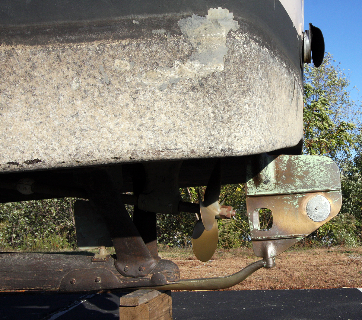

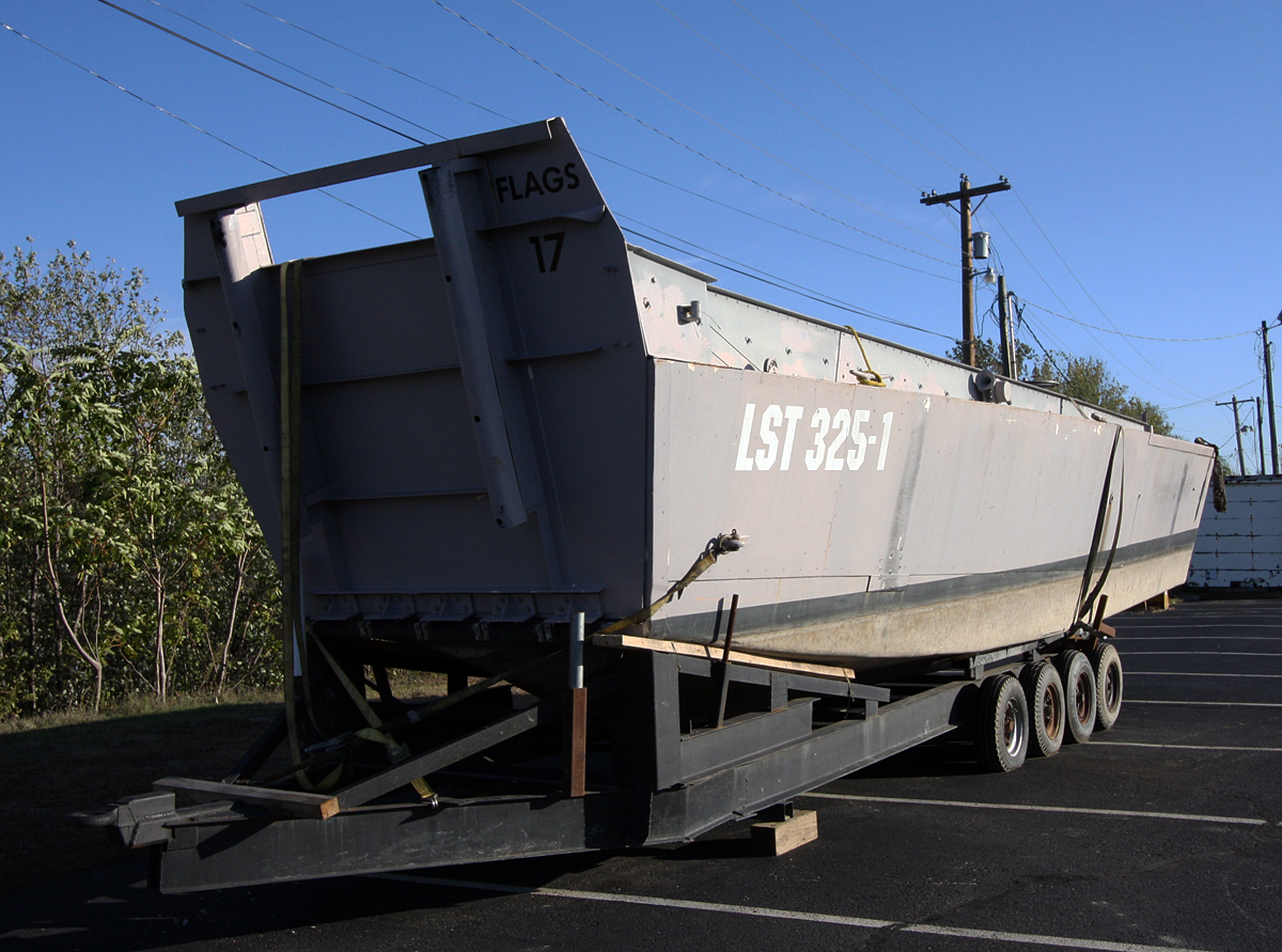

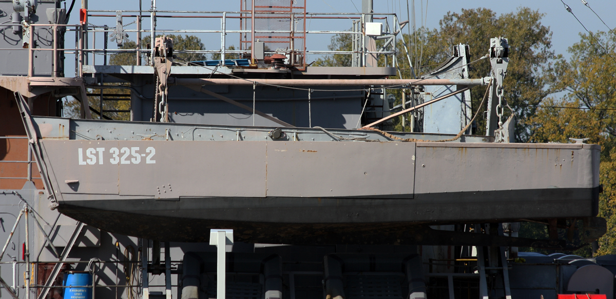

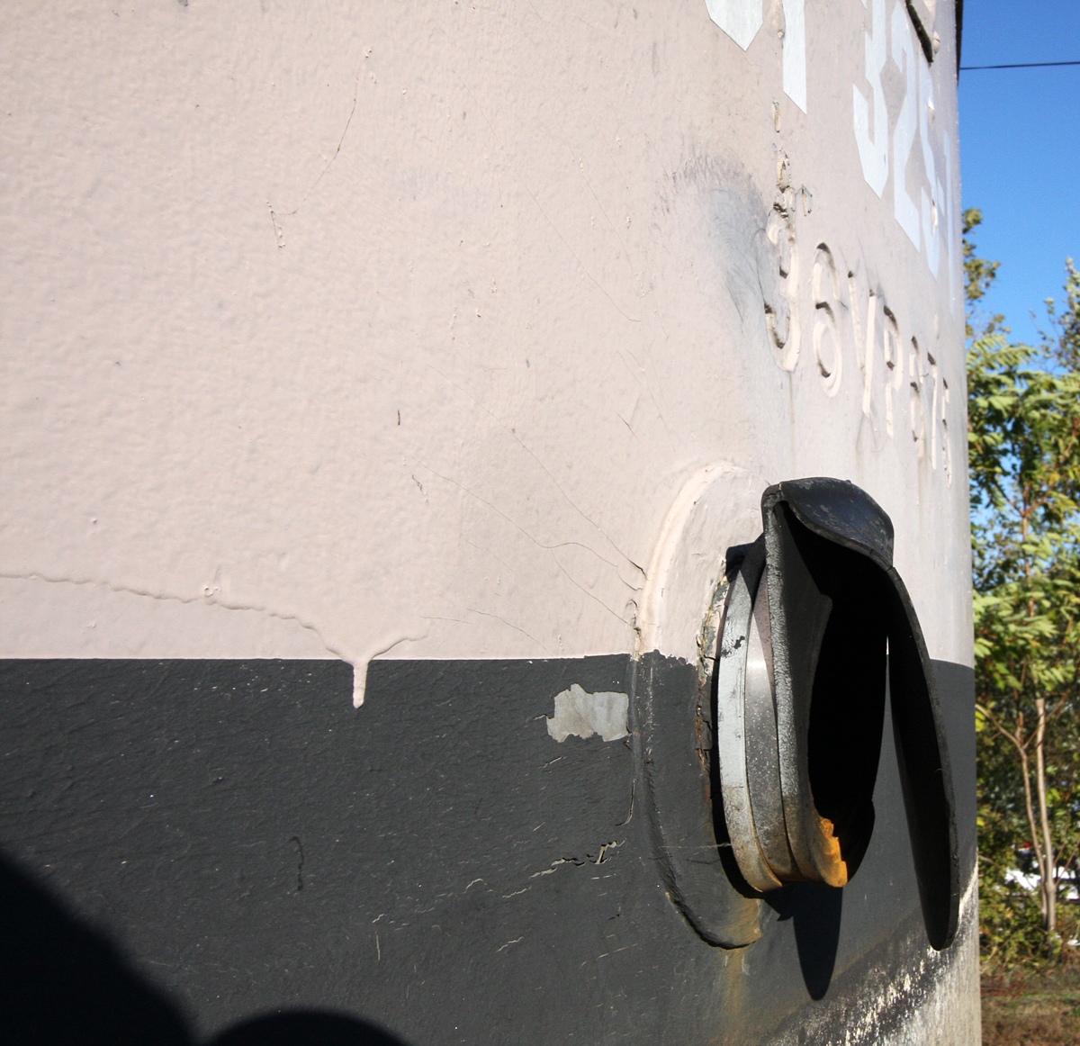

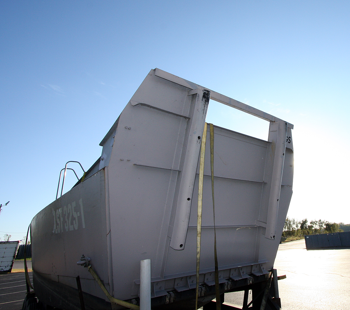

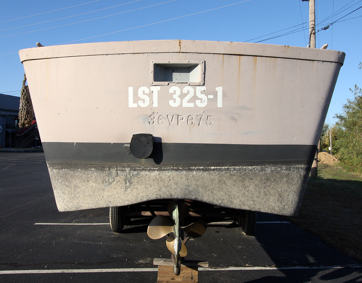

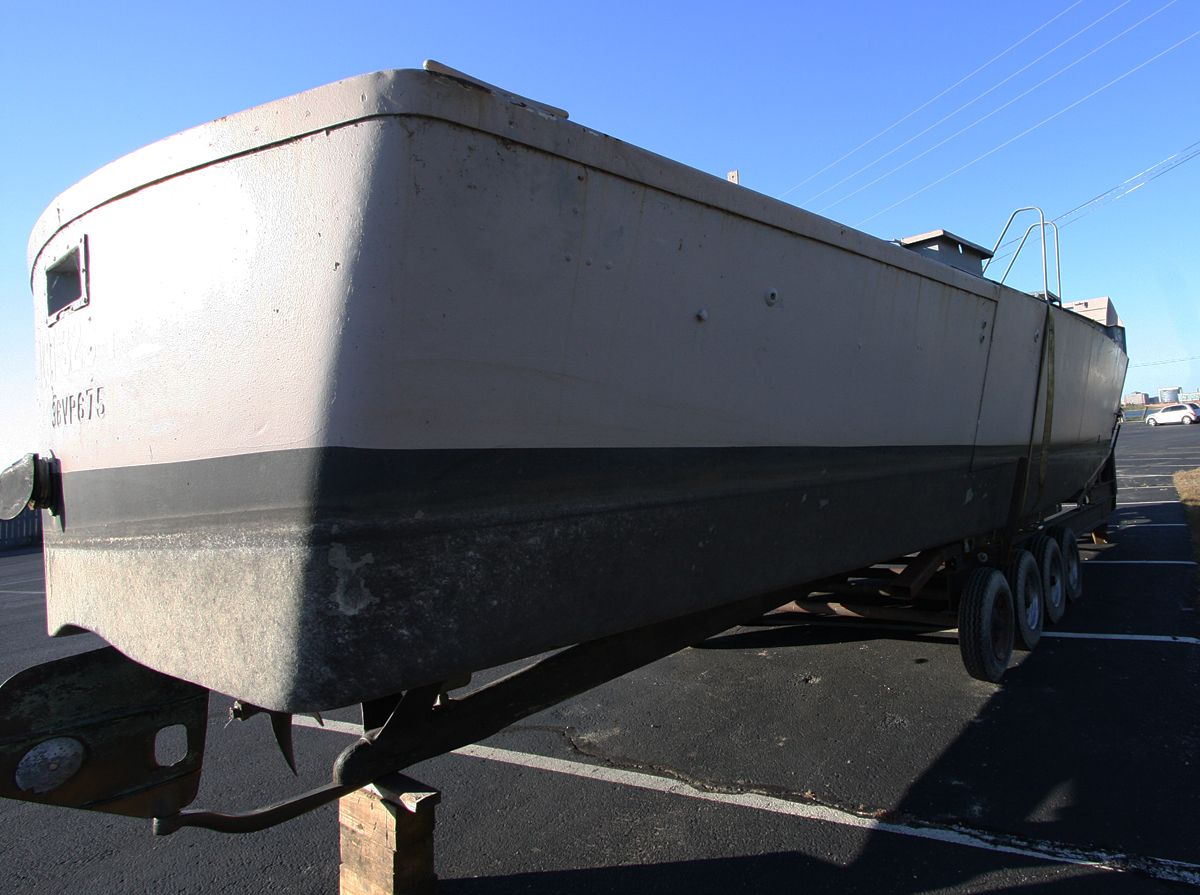

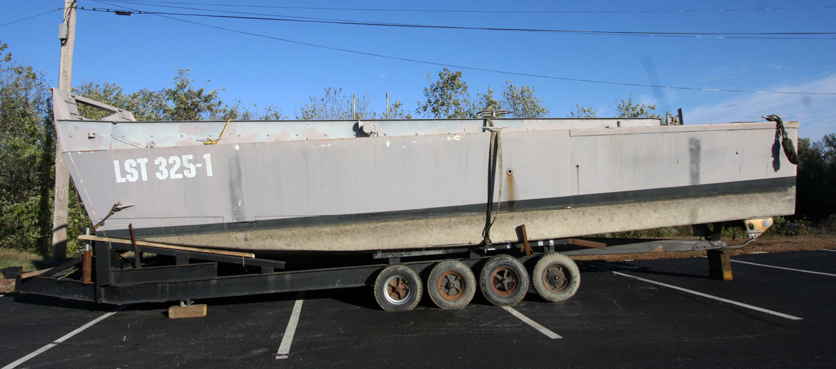

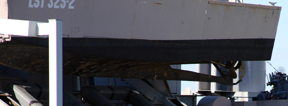

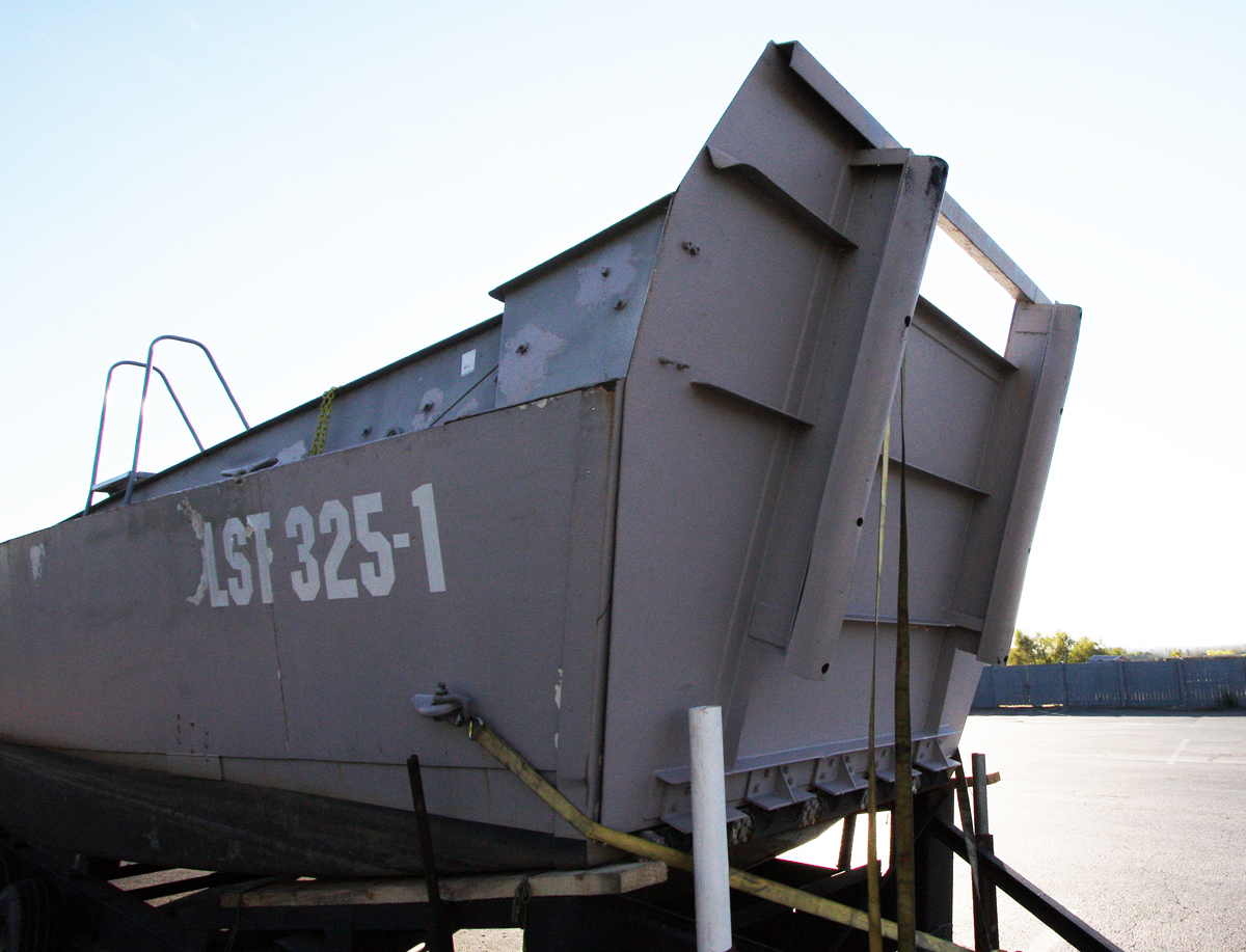

Don't know if you need photos for your build, but I took these when I visited LST 325 a few years ago.
Rob
