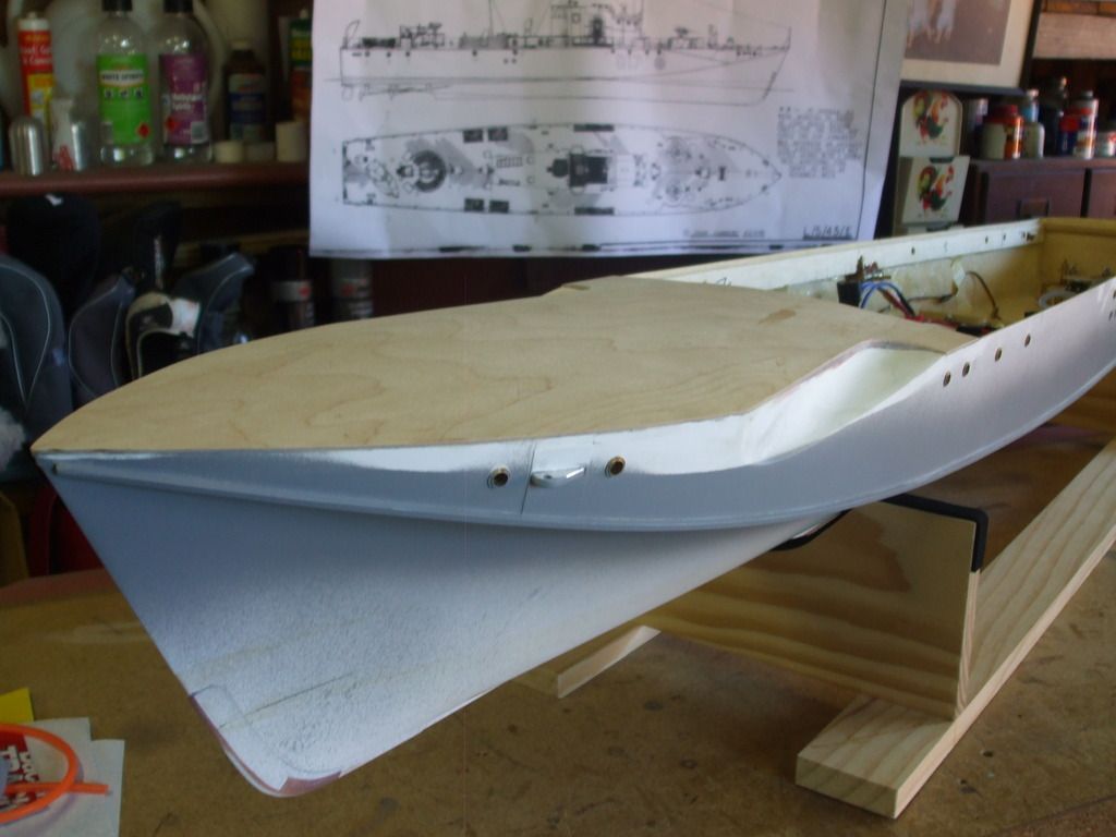

Hi a bit more progress deck on bow.
Graham
