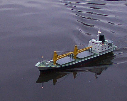

Graupner Sydney Star
scale 1:200
Length: 1150mm
Beam  : 140mm
Motor: Graupner speed 500E - (main)  / Graupner Bow Thrusters C/W Speed 400
Propeller: 35mm M4 - Kit supplied.
Propeller shaft - Kit supplied.
Speed Controller - 3x Viper 15 Mtronix
Battery 1x 6v 12AH Yuasa Lead Gel type
Rudder : Robbe 40x45.
Radio Gear: Futaba 6ch,
Run time: 7 hours
Go Nuclear!  you'll love it

Graupner Neptun
scale 1/87th (HO)
length 760mm
beam 140mm
Motor: Mtronix Vision 400
Speed Control Mtronix marine 15
prop 30mm kit prop M2
Battery 7.2v Nicd or nimh
Endurance: 4 hours with no loss in performance
quite happy at scale speed and will go slightly faster than scale speed
*** FITTINGS KIT EXTRA TO THE MODEL ***
*** REQUIRES ABOUT 1.2KG OF BALLAST WHEN USING NICAD PACKS

Cargo
