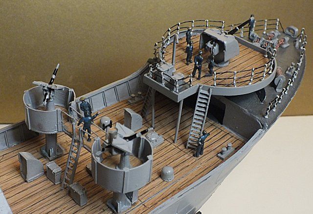

HMS Royal Marine, ready to sail
It always seems like the many last little details take forever.  Masts and rigging, various stairs and ladders, lots more handrails, and of course breaking out my tiniest brushes to detail seventeen 1/96 crew members.  Somehow no model is complete without some crew visible, plus it gives a sense of scale.  Several light coats of Pastikote satin clear varnish to protect the finish for sailing.  Lastly the glazing can go behind the numerous windows and portholes before the last sub-assemblies get glued on.  Wiring LED’s
I am quite pleased with my somewhat modified 4 inch gun.  It looks about right, especially with railings and crew alongside.
I find that these builds make a refreshing change from long term projects whilst still giving plenty of scope for customising or adding extra detail.  My next build will be ten times longer with a very high proportion of “scratch” in its construction.
