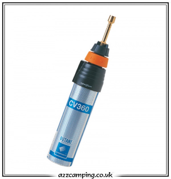

I have the camping gas one, as far as I can tell its still working on its original cylinder, but the cylinders are tricky to get nowadays
grendel
