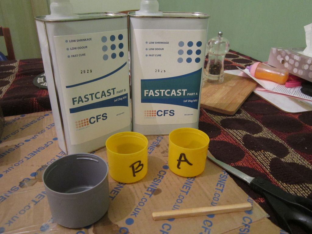

Well this stuff arrived this afternoon........think I might just have to have a play later on afterMrsStav comeshome and relieves me from childminding duties

that looks interesting, Stavros. is that resin, and how long does it take to cure.
I look forward to seeing your fittings. Are you going to cast the brass parts as well that you made earlier.
Jim.
Re: Tid Tug 164 Build Models By Design...The BIG UN
« Reply #83 on: February 06, 2017, 02:52:28 pm »
 Yes it is resin Jim apparantly it takes 10 to 15 mins to set...and as to Casting the brass fitings that I have made the simple and really is no.

 if your casting  always have a spare mould near you as you always mix a little to much (which is better then to little)
 means at the price you pay for the stuff  nothings wasted by the way may i ask where you got it and how much you paid and I may be wrong but I have been told this stuff only has a self life of six months so I only buy 500m or 1kg bottles hope am wrong on this, I know the clear resin I have has thickend up over the last year while we have moved.

CFS fibreglass is where you get it from Howard they do a mail order service.There all the time being a boat builder spot on firm :-))

£22.50 inc vat probably some carriage to Howard for the same 2kg pack same as Stavros.I'll be interested in seeing how the casting turns out always thought of trying but never got round to it %)

The resin has cost me £30 including postage and packing,that is for a 2kg pack which is the smallest they do,and yes unfortuantly there is a six month shelf life...so I plan to use the whole lot up and then sell what I have left over to recoop the price of the resin and then anything I do after that all the proceeds will go to the RNLI.....anyone need some 1/12th vents and funnels then please contact me !!!

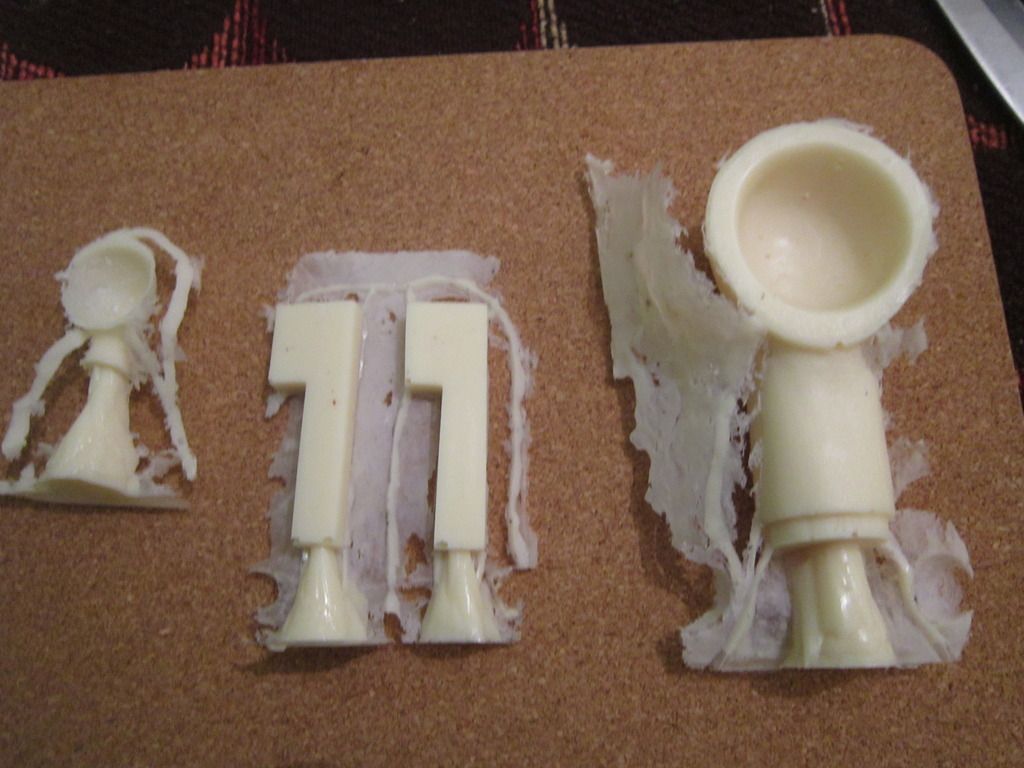

Well here we are the pics of the casting.
To be  honest I was very lucky in that the aerosol tops were a perfect amount to fill all the moulds up in one mix....begginers luck without a doubt
Waiting for the resin to cure
Wey hey it has worked
I made up 4 mixes last night
I will be casting another 4 mixes up today of the small Gnv vents,obviously all the vents are going to need cleaning up this is  a simple process of rubbing down with some 240 grit.

That looks good Dave.  I'm very interested in your results.  You'll have to let us know how sturdy and workable the final piece comes out.

Sturdy is an understatement 100% success rate......very easyto works the resin an hour after comming out of the mould...tried some of yesterdays and still very easy to work and sand

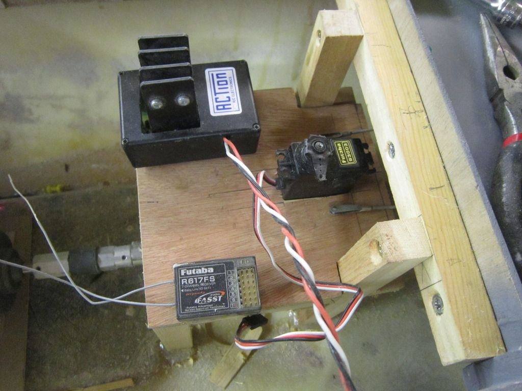

A solid servo mounting was needed as the Barn door rudder puts a lot of strain on the mounting point so some rather agricultural looking frame was constructed out of 20x20 pine this was screwed actually to one of the deck beams the feet of this will be set into P40 at a later date
This has had a piece of plywood fixed  to it to not only hold the servo but the Esc and receiver...but that might change ...a Hole has already been cut for a servo
Rough idea of where everything might go
Next job is the Horrible one in my mind...A motor mount has to be made BUT the major problem is two fold really ....only 5mm underneath it and not only that but it has not got any mounting points ...so thinking cap is now on

Looks like a cradle and strap arrangement will do the job as motor mount.

Hi Dave, is that the battery that you will be using in the TID? if so wont it cause problems with stability, being so high in the hull????

I had this batt in her before and I also  run the same batt in the Happy Hunter thats over 5 feet long as well
