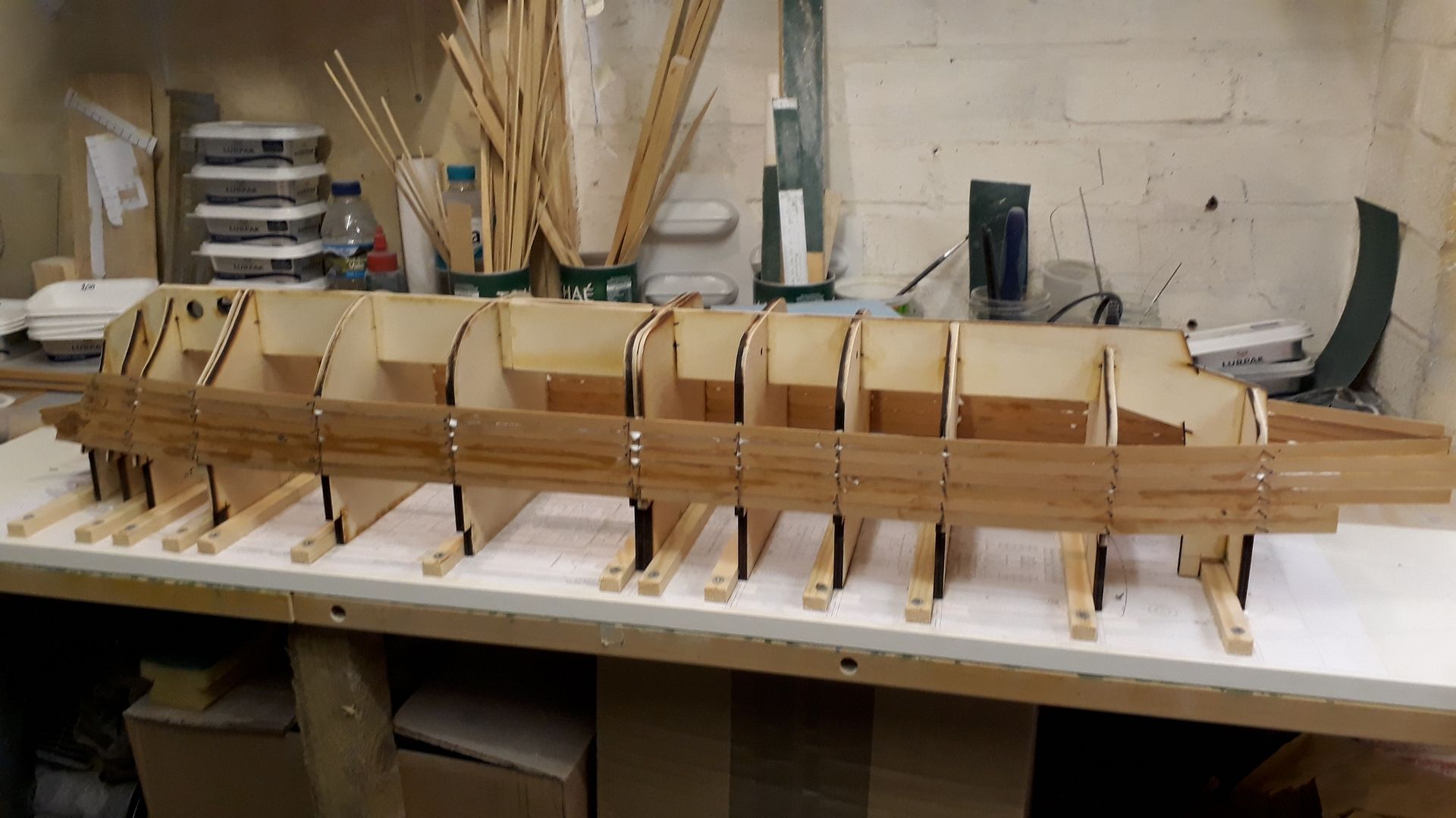

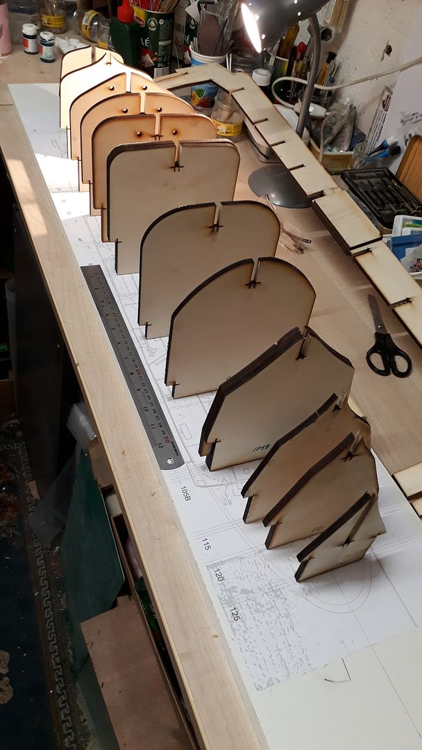

As is now usual practise for me, the plug has been created plank on frame, with the frames and keel being laser-cut from 6mm quality plywood:

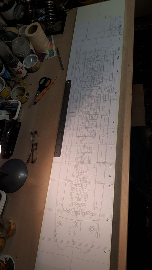

These were  then glued to trued and squared battens and, when dry, the whole assembly was screwed down to the building board, over a copy of the deck plan to ensure alignment of the frames.

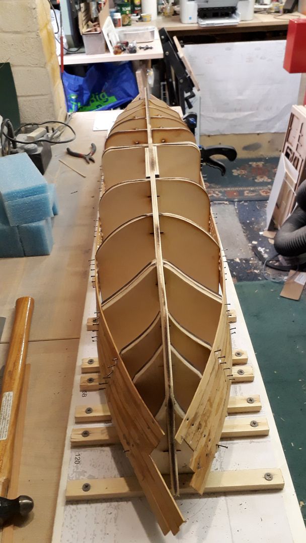

The planking could now begin!!!

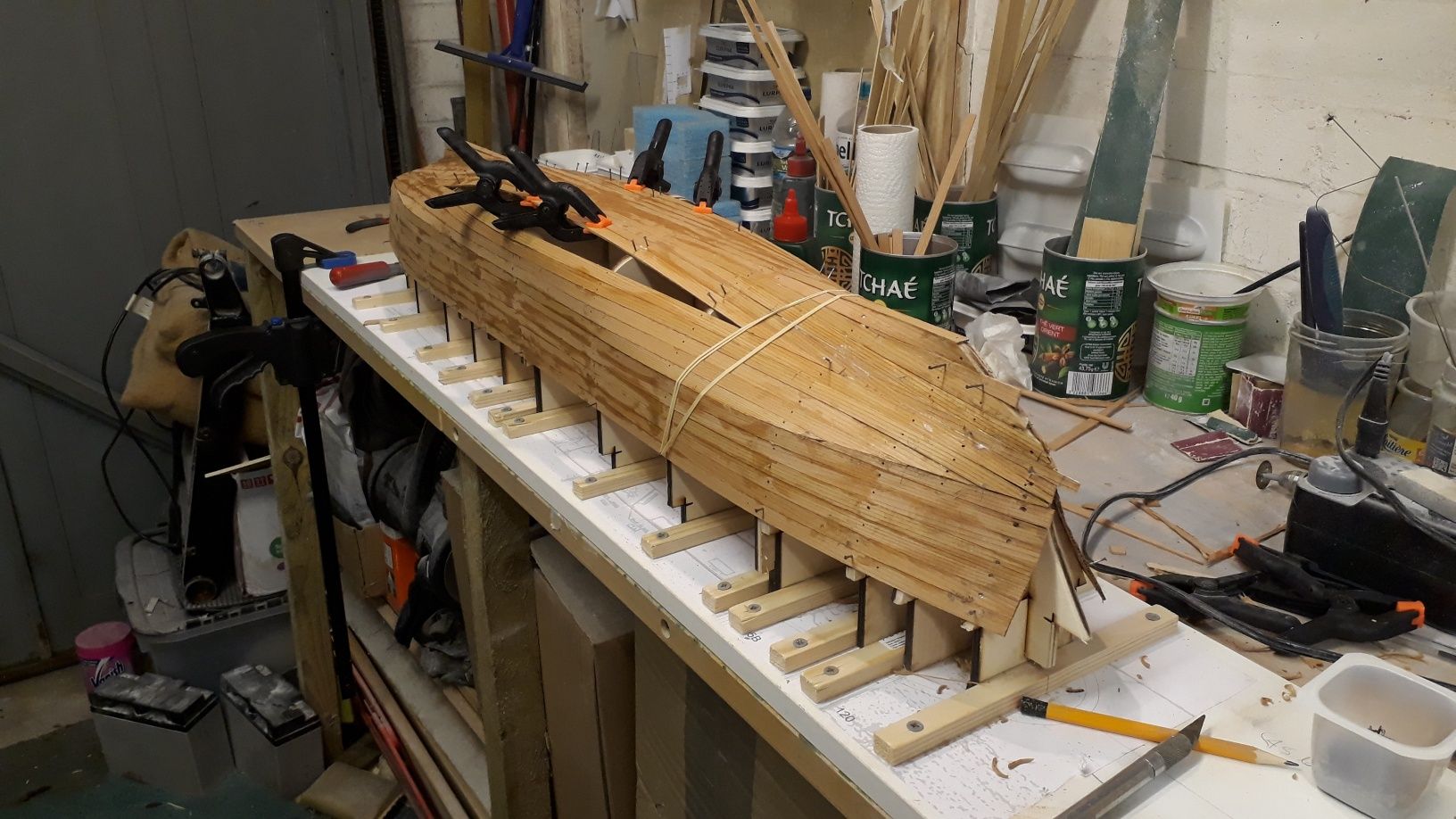

And here we are as of this evening:
Bow and stern will be blocked in and sanded to shape.
We should have an early prototype for show by Warwick this year (where we will be expecting to announce the availability of the Spirit of Free Enterprise) with deliveries being able to commence early in the new year.
