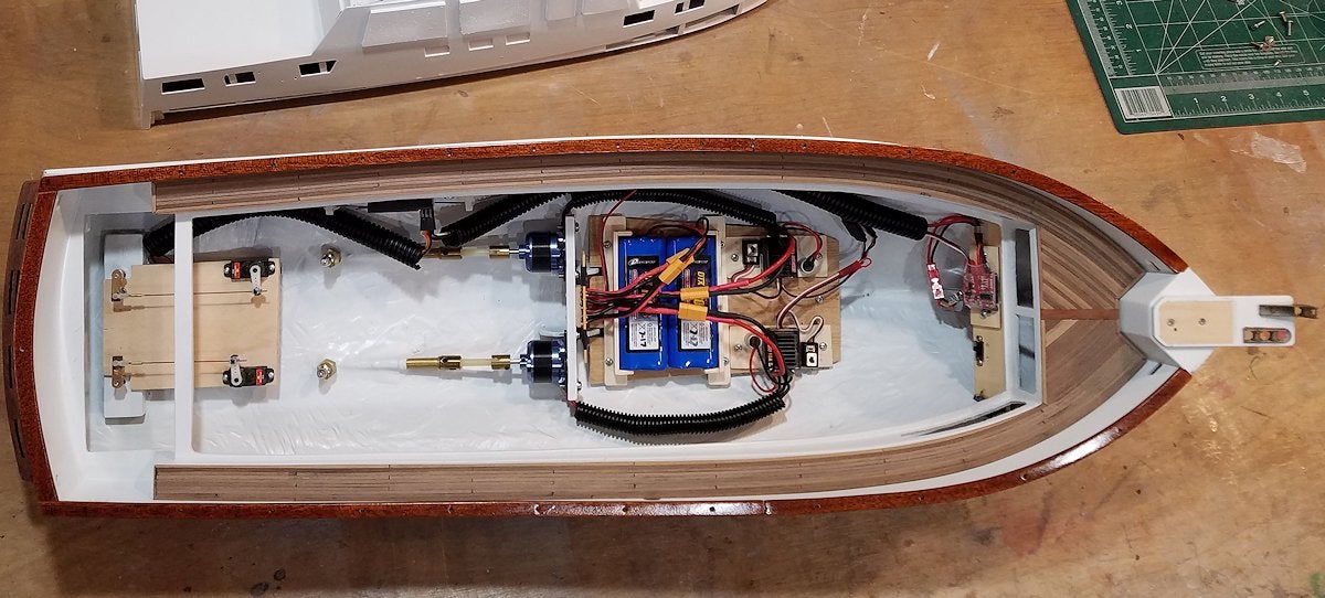

HI Guys this post seems to have stirred up a few people so lets all calm down.  The official title should read Grand Banks Heritage 46. I have now checked the kit and marked all the parts ready hopefully for a build to start in late September. To lighten the kit much of the material will have be substituted and various parts remade from plastic card and wood veneer applied over the top. With regards to power for this model  I need your help with brushless motors for this project. The model is 880 mm in length two shafts 35mm props 7.4 lipo. Do not need high speed motors and of course E S C.

Given twin props I reckon the motor I've used in the Lobster boat would be fine 28/36 750kv mine is turning a 45mm 3 blade.
This will give 5,550 rpm max at 7.4 volts. Obviously more on a fresh charged battery but it only goes as fast as you make it.
Currently no stock but I've set an alert for when they're back. Really cheap!
https://hobbyking.com/en_us/turnigy-d2836-11-750kv-brushless-outrunner-motor.html?wrh_pdp=1
Alternatively they still have 950KV in stock same dimensions 7,030 RPM at same volts
I have a spare motor if you wanted to take my advice offered so you could set up your drive train.
This is the ESC I've used and I'm very pleased with it. A little sweetie and dead easy to program once you grasp it.
Again the price is keen
https://hobbyking.com/en_us/trackstar-30a-1-16th-scale-sensorless-brushless-esc.html?wrh_pdp=7

Hi update on my winter project. Materials purchased for construction of the cabin area light ply and styrene to be used. Brushless motors and two E S C  and lipo batteries will provide power. Props and shafts still to be purchased. Two pictures showing the b/ less motors that may be used.
