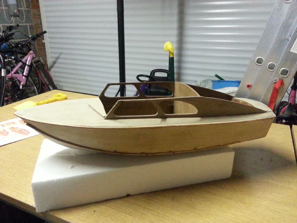

I'm looking into resurrecting an old craft (35yrs+) - a Modav 'Sea Vixen' same as this
and hoping for helpful suggestions as to a suitable electric motor.
It is, in theory, a planing hull - hard chine with a chine rail on each side. LOA 64cm, beam 22cm, weight (without motor/batteries/RC) 1200g.
Any thoughts please for giving it a reasonable turn of speed? (I'd also be asking for appropriate prop ideas too).

Are you missing a picture on the post?  Does it already have a shaft and propeller (diameter and type, e.g no of blades)?
Do you want to stay brushed motor because I guess at some point soon you'll get allot af answers and some will say brushless and Li-Po.  Some folk's definition of a "reasonable" turn of speed is different from others.  I'm old school brushed and Ni-Mh so with the pic and propeller details it might help put something together.

Hi Rich, I think 'this' in my msg is a link to a pic? (If I've posted it right). Or https://www.modelboats.co.uk/sites/2/images/member_albums/121166/old%20boat.jpg
The shaft is in there  - 8BA or 6BA thread, iirc. Yes, it's from that far back! I have a two-blade prop on there at the moment, 40mm but I guess that's easily changed as necessary.
Brushed/Brushless is more modern than my antique knowledge, but I would expect brushed would do me. I would probably be looking towards LiPo for the better energy vs. weight (and I have a charger for all types). I can dig into ESC etc once I know what motor/voltage/current I looking to.
