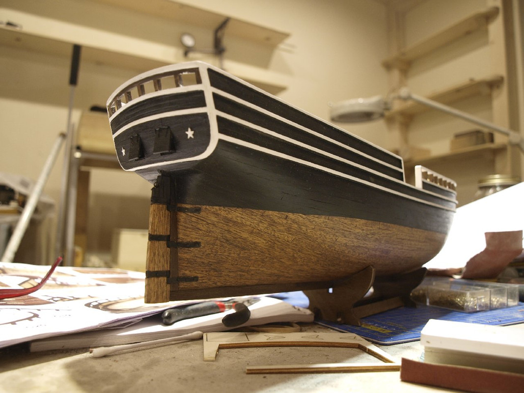

« Reply #1 on: January 26, 2020, 09:24:40 pm »
This is very impressive work. I like the way you have done the planking and how you have shaped them.  :-))
  • Posts: 9,471
Re: Occre whaleship Essex
« Reply #2 on: January 26, 2020, 09:54:09 pm »
Yes....must agree, an excellent top planking layer & rubbing strips  :-)) ....the deck planking pins also look fine in bronze [brass]
Keep us posted with images as you go

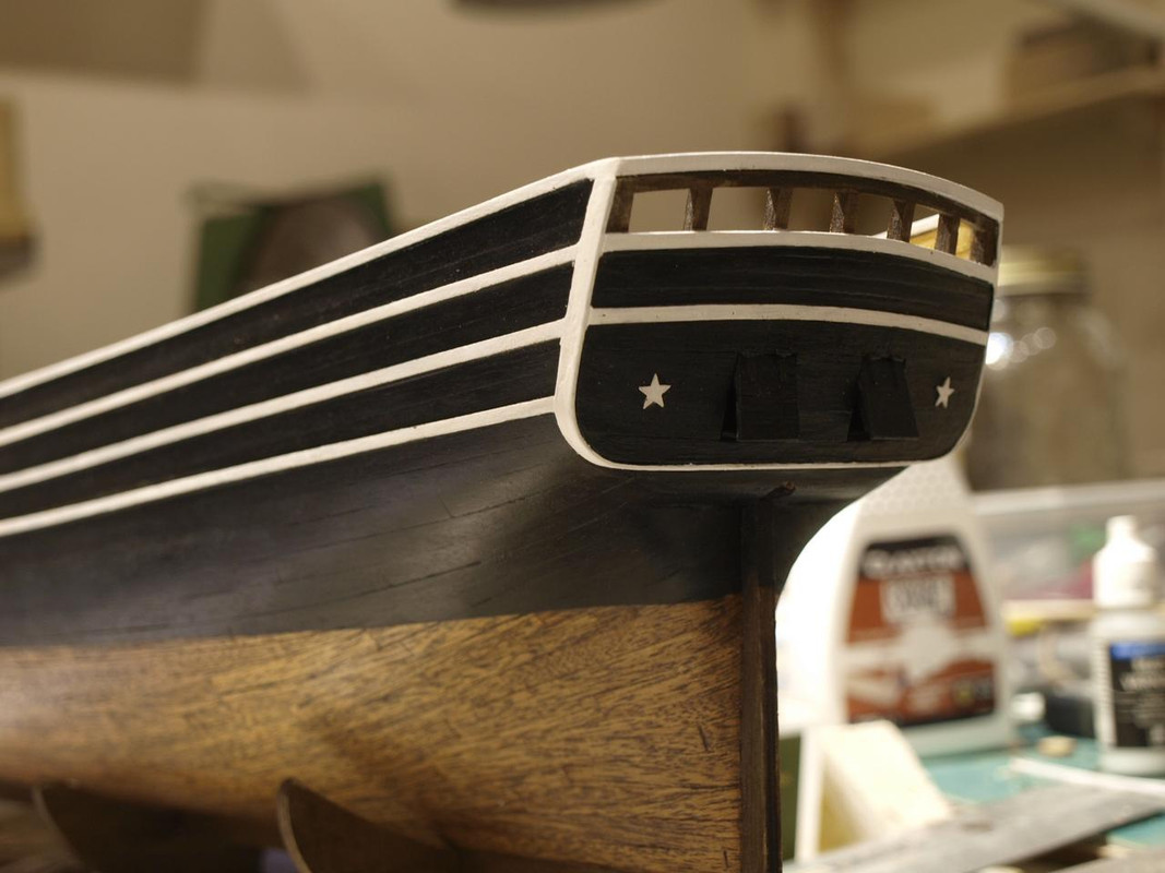

dock nails are made with iron wire, I do holes with a pin and then I fix cut wire with shellac.. when it dry I sand with 400 grain sand paper
Colors are black Tamiya flat and Vallejo white pergamino, all visible wood shellac only

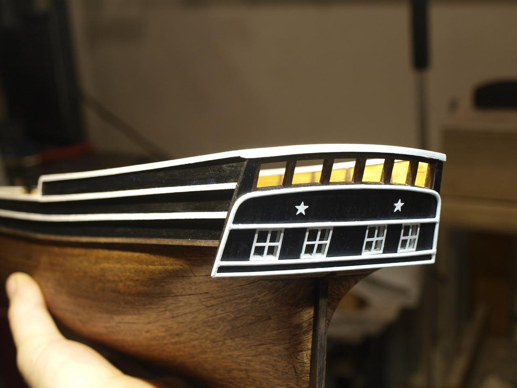

I changed the kit's transom, actually I had built it with the windows as indicated in the instructions..
here you see the first version, difference from kit manual: only the gold color has turned white (really there is no gold on my Essex)
but a 4 windows transom I can't see it well for this whaler.
so I redone the transom in a different way with only 2 portholes for waste
if you want to compare the differences this is the occre Essex

Many dock elements
I have cut the wall here, I have a different idea..
Rudder work well, is dinamic.
