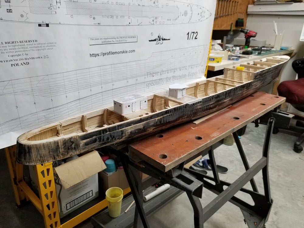

I started with the plans by Profile Morskie, which are excellent overall but with a few inaccuracies... the big problem is that there are very few reference images on the 'net, and good references are hard to find.  I ended up paying almost 300 dollars for M. Brescia's 'Mussonlini's Navy', which did provide excellent information on the class but had only one tiny picture from the 1930s of this particular destroyer.  I plan on buying a camoflage reference book with port and starboard views of the complex splinter pattern by the time I get around to painting.
Everything started out well enough with a normal upside-down hull on a building board... nothing that needs any detailed explanation.
I planked it with black ash wood.  Why?  Because it was free, in 5ft lengths, and given to me in plank form.   %)   I would say it's flexible for a hardwood, but nothing as nice as basswood to work with.  The upside is that this hull is borderline bulletproof.
Of course, no planks would fit the curves at the extreme bow and stern, so I used vertical planks and carved basswood blocks fore and aft to give the hull its final shape

That planking looks tidy.
You dont see many spokeshaves these days.

« Reply #3 on: March 28, 2020, 08:14:47 pm »
They're still out there!  Veritas over here in Canada makes two very nice modern spokeshaves, and there's lots of old Stanleys like mine floating around.  I find they're the perfect tool to round over the edges of planks while fairing out the curve of the hull.

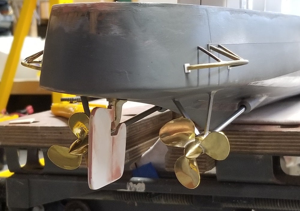

Getting close to where things are at now, here's the propeller guards on the stern and the 40mm Type 162 props.  The rudder looks a little on the small side, but I intend to try out a new computerized radio with this one that will let me mix the two shafts to maneuver better.
