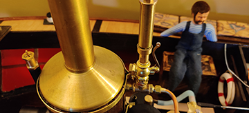

How do setup a steam Whistle attached to my boiler to a servo. Is that the way to do it or some other way?
It has a little arm that has a spring that allows it to pull forward and spring back after you release it after "playing" the whistle.

This is how I did mine after I stripped the servo gears when the pull line was too short. I made the compression spring out of a biro spring and a paper clip, it’s a miniature copy of the mooring springs that yachties  use.
Jerry.

Thanks for all your advice and inspiration. Here is what I did after looking at your work/suggestions.

Hi Derek - sorry I never saw your post but it seems that you have got it sorted  :-))   Does the valve need to be held shut by the servo or is it self closing?

The whistle has a little spring that self closes but I have not figured out how to set the micro servo to "open/close".
I have to hit the servo channel (3) once to play the whistle, once to close it.

You can also get that lazy bearded Deckhand >>:-( [who is getting a free ride] to swap seats....then link his movable arm to a miniature chain connected to the whistle, then have this hidden back to the servo

That works but looks a bit bulky. You could simply replace the rod and clevis with thin fishing line including a spring servo saver like I showed you before somewhere in the line. It keeps the line taught but prevents servo locking and stripping the gears.

Derek 2 ok2 , you can hide the little servo in a small wooden box and, as the whistle valve is auto closing and facing its servo, I would kindly suggest you to use a thin cable or chain instead of your big metal rod.

A piece of string or a thin chain is really all that's needed for a steam valve. A spring servo saver is completely unnecessary in this application, since the whistle actuation requires little force and is only done momentarily. But I have to say your servo saver and rod look nicely made, I would reuse them for the steam valve, where they would be more useful.

Getting closer. Did a redesign to make it a little simpler and added a box. Will fine tune the box and add a little side piece to hide the servo arm coming out.

I use very fine fishing leader which is barely visible and also goes around tight corners works great.
