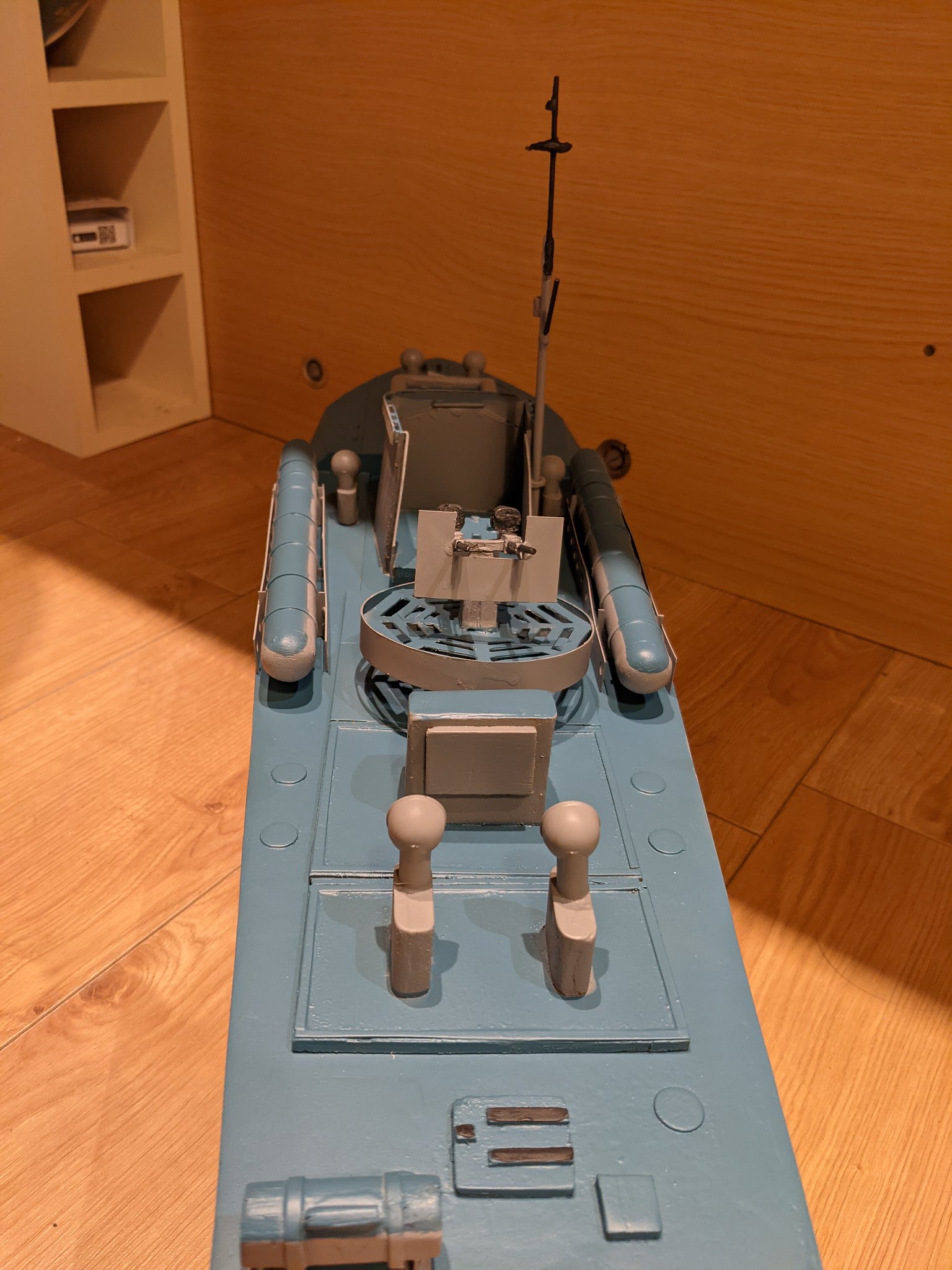

« Reply #7 on: November 12, 2021, 10:16:11 pm »
Another large jump in progress since last time, Bollards added, all fixtures, Gun, torpedo tubes etc glued in place and the paint job finished. Really happy with how its turned out. It passed bathtub tests too. Hopefully find a spare hour this weekend to pop to a local lake and give it a proper run, think it's gonna be a fast one!
