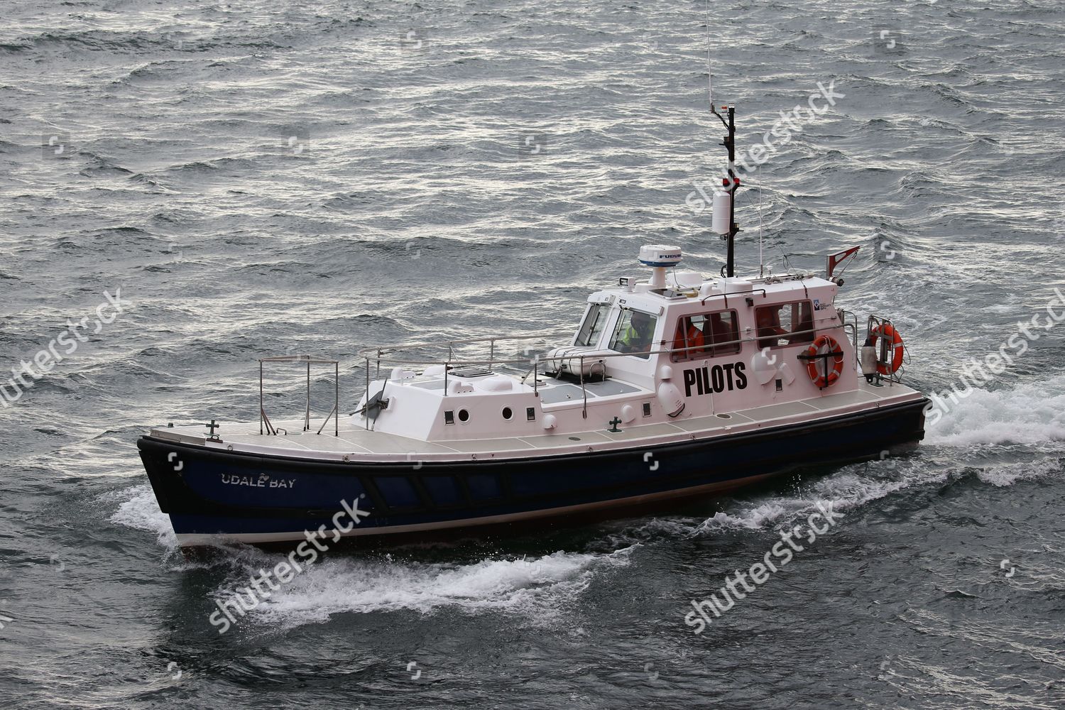

Here is is a couple of pics of of Nelson 40's:
https://editorial01.shutterstock.com/wm-preview-1500/5729233c/42012979/Shutterstock_5729233c.jpg
https://www.shipspottersteve.com/uploads/1/6/9/2/16921916/2681852_orig.jpg
