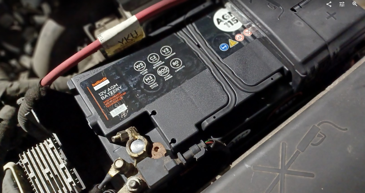

  • Posts: 24,075
Re: Car battery?
« Reply #23 on: December 06, 2023, 07:02:41 pm »
Today, 5.30pm
  • Posts: 12,536
Re: Car battery?
« Reply #24 on: December 06, 2023, 07:07:15 pm »
That looks like the expensive type for larger vehicles Martin - are you driving a Humvee?
