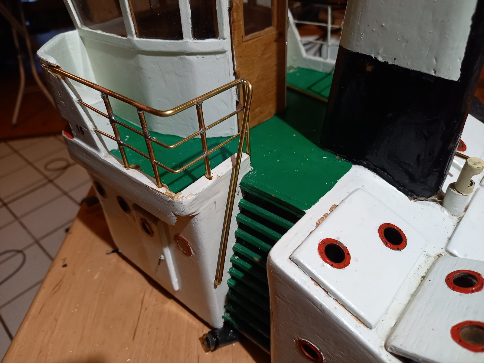

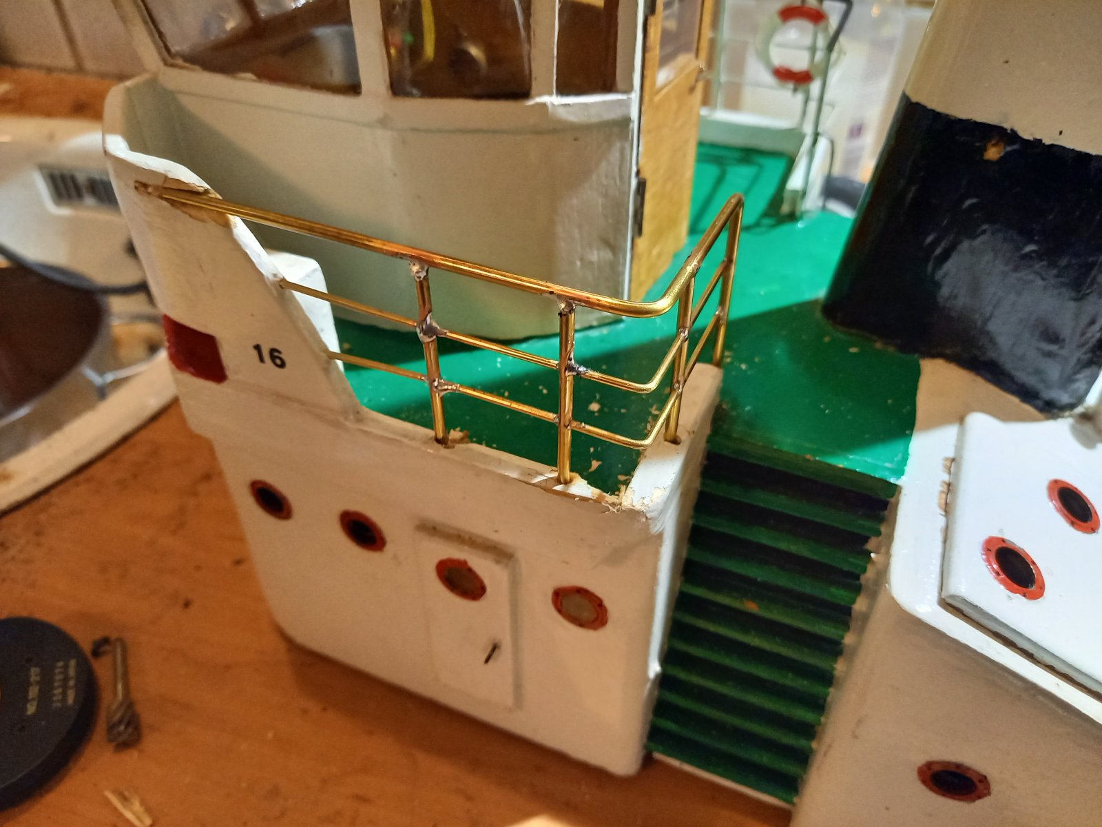

Making a start with restoring the cosmetics of the boat:
The railing of the starboard bridgewing is still "reasonably intact" but portside was missing the webbings and was one stanchion short to begin with, and aside from that, the construction was very fragile with 2 mm toprail and 1 mm webbing, all connections glued.
This is the first time EVER that I made something like this, and I had the extra difficulty of having it fit the existing holes in the superstructure. So I am not unhappy with it.
Made the stanchions and toprail out of 2,5 mm, and the webbings in 1,5 mm, looks just that bit better to size. Drilled the stanchions, and soldered all connections:
I had to do the soldering "in situ" because the finished item, soldered and all cannot be positioned in the holes, those holes being in all different angles. So I had to use tin and an iron, could not use a flame and silver.
EDIT: oops... the handrail for the stairs still was on the workbench...
Remaining glueing and bondo-ing the holes, and painting, and then... Oh dang, repeat this for starboard...
