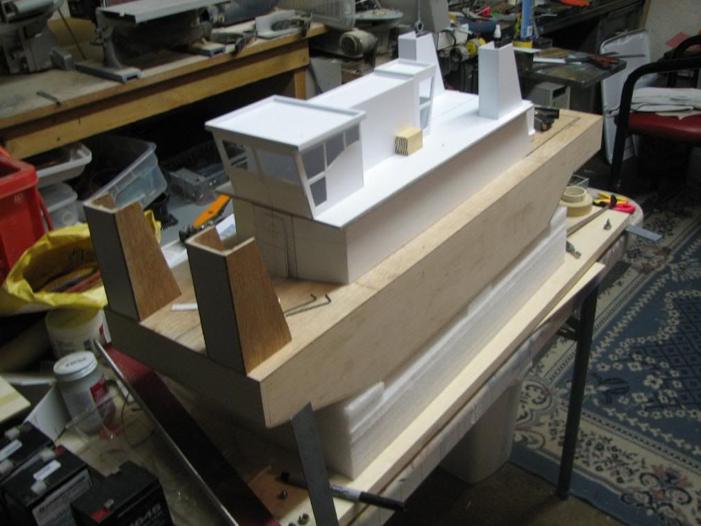

The three freelance models shown here include a 70 in hull with 5 different superstructures available , a 51 inch hull with ten and a 40 in Elco hull with 8 superstructures.
The motors anmd universals in all three hulls are the same ROBBE 755/40 with Robbe Navy ESC. The small frigate has a single drive train as does the MTB.
The MTB ( 5 bladed 45mm brass prop )  planes beautifully however the running time is limited to 15 minutes of full throttle...
The smaller frigate is capable of running for 60 minutes on one charge of the 12V 5ah gel cell.
The 70 in hull will be launched soon, a 12V 9ah battery will hopefully provide 45-60 minutes on the pond.
There are many advantages to this system, the biggest is economy. I am able to build a new superstructure for less than $100.00 for the 70 in hull and approximately $40.00 for the PT boat and small frigate and of course the performance
for each " new" model is predictable.
The freelance concept would be very attractive for a grandfather wishing to share some quality time with a grandson. The grandson could build his own superstructure-deck and when it is time to sail, take two batteries to the pond.
Cheers from my freelance dockyard
John in British Columbia, Canada
