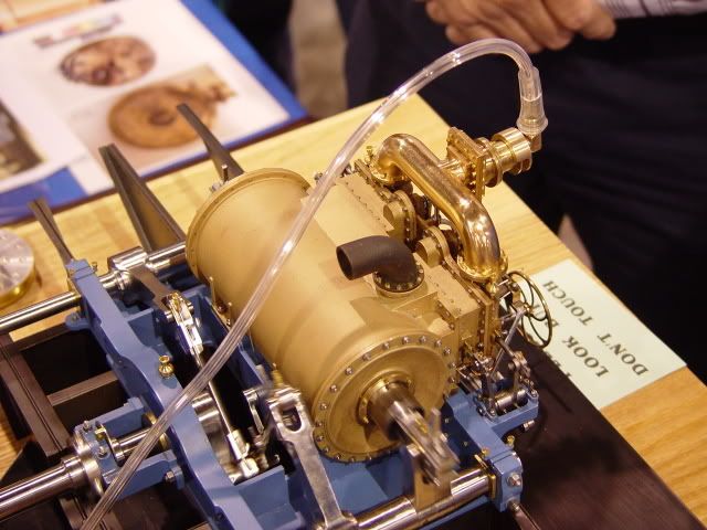

As this is a friends, this is a one of a kind scale replica of the Monitor's engine. The 1/16 Scale Steam Engine of the U.S.S. Monitor. First are my pictures taken over the couple years at  the North American Model Engineering Show or N A M E S It is patterned after your big show.
Every part has been precisely scaled from badly faded working drawings, personal observations and photos shot at it's final resting place, The Mariners' Museum at Newport News Virginia. No castings were used on this model. All parts were machined from billets of it's respective metal.
Enjoy

Absolutely beautiful and a real pleasure to simply look at.  I can only imagine what the complete model is going to look like if this amount of work is going into the engine alone!!
Many thanks for the pictures, I really enjoyed them.

He isn't a boater, when you see his other engines. You will understand, he is already planning his next project. While working on the book and plans. But the most amazing thing about Rich is. he is very generous on sharing his knowledge gained thu building them and will tell you everything. He just did an article in the US live steam and outdoor railroad magazine on the making of the crossover pipe from built up billets. with a ton of pictures. as most don't believe he milled around the inside curve with out any fancy equipment.
Standing with him at the show and listening to the bench experts, tell their friends about how he milled around the curve with a flex shaft ball end mill in a mini milling machine. If I remember correctly Rich only has full sized machinery. And I'm still waiting for the company that makes ends mills with a flex shaft coming out of the ball. the guy hasn't answered my repeated emails for the company name or web site %% :}
So no model of the monitor as an RC boat.
Oh and something else every oil cup and drain petcock along with the copper drain lines works it is truly a scaled down replica.

A couple of questions (for the steam buffs)....
1. Is a gate valve normal for the main valve for a steam engine?
2. The rotation "seems" non linear.... constant, is that just because it's a model, running slowly?
3. How "good", (efficient, reliable, powerful) was the the real engine?
4. I guess the big wheel in front of the engine is reversing gear?!?!?
5. What's the 'balance valve' for?
PT Sideshow
Re: The 1/16 Scale Steam Engine of the U.S.S. Monitor
« Reply #5 on: November 07, 2008, 03:04:49 pm »
What I know about the engine, is little and general in nature. I do know that the experts at the Smithsonian museum put the mock up of the real engine they brought up out of the drink together wrong so, it would have come apart in a very spectacular fashion. That this engine is by the same Ercsson of Sterling hot air engine pumping fame.
#1The admission valve is a grate valve as it resembles the grate over sewer grates. Long solts cvered by a corresponding gate with slots cut in to it.
the answer to #4 is yes.
#3 I don't know if it was used long enough to come to a conclusion if it would live up to the hype as it was not a cost effective engine to build.
#5 if you are referring to the balanced main steam chest valve, it had to do with getting equal stem to both cylinders.
#2 I believe that had to do with the smoothness of operation I do believe that the full sized would only run at a relative slow speed as far as RPMs go.
By the way I forgot to mention that he has about 3000 hours into it.
I have let him know that I have posted it here. and maybe he can answer some questions,  And correct me if I was wrong on any of the above!.
« Reply #20 on: April 23, 2010, 06:44:20 am »
Martin asks .......2. The rotation "seems" non linear.... constant, is that just because it's a model, running slowly?
1. when we consider a double acting single cylinder engine.....as the piston approaches TDC or BTC it is at it's hightest acceleration
2. due to the nature of the crank construction..the actual piston speed then hence direction makes a dramatic reversal
3. there is even a theoretical minute period of unit of time when the piston is considered stationary @ TDC or BTC
4. so the viewing of non linearility of motion is not an optical illusion
5. yes, higher rotational shaft speed sends this to a blur ....but the non linear motion still occurs
If we consider the same design engine but with two double acting cylinders
6. the apparent non linearility of motion is halved as when one cylinder is approaching it's highest acceleration..... at the same time as the other piston is reaching an 180 degree out of phase acceleration ...so this effectively dampens out the effect....Derek Inocent
