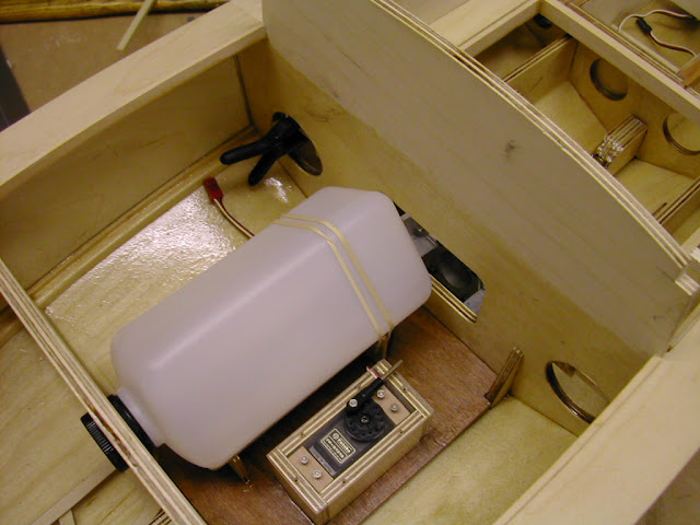

Hi all - I'd like a bit of advice please.
Having looked at working on the topsides I think it would be best to get the radio and fuel tank installed before installing the cabin sides and coaming. This will allow me a little bit easier access and will  prevent me from probably ripping the coaming off accidently while working on it.
Looking at layout I think it would be best from a CG point of view to install the radio gear (batt, rx and throttle servo) in the forward cabin bay (the fuel tank is in the aft cabin bay just in front of the engine)
As this will create a long (mechanical) connection to the rudder I am looking at installing the rudder servo in a separate box closer to the rudder in the aft bay. This will mean a long servo connecting lead running past the engine.
Is this likely to create radio signal problems being so close to all that metal to metal whirring round?
What do you normally do with the aerial wire?
In the past I have installed a 'snake' outer running around the bows and 'push' threaded the aerial through this but that was on 27mhz and on a much smaller expanse of water. Would this be good enough for much further 'outings', say 500 - 1000 mtrs?
As always your advice would be appreciated
Regards - Ramon

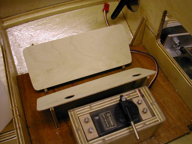

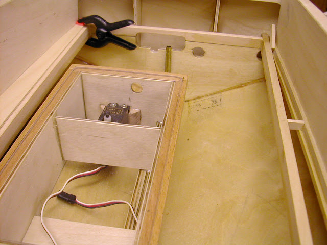

Hi guys thanks for the response.
Andy, I had not forgotten your tip on these boxes but as I remarked at the time there is not really enough room in the aft area to fit one.
I have considered the CG question in my thinking. I'm not sure if it shows it on the plan (still with Peter) but I would hazard a good guess that it will be in the area of that main cabin bulkhead possibly just ahead of it. With the engine sitting just aft of this the fuel tank (600cc) will be on the forward side of it running lengthways between the two bulkheads. I can see that a diminishing tank will have some influence on trim but with it's closeness to the assumed CG I would think that the effect will not be too noticeable.
Like wise with the R/C gear. If I put it in the aft end bay not only will it be near the intended position of the silencer but all the weight of the 'hardware' other than the fuel tank will be on the aft side of the CG. This could then mean having to put ballast in to get the trim right. However if it does turnout a bit bow down with the gear in the front
then I'm certain a much smaller amount of ballast will be required.
I'm still concerned about signal noise being picked up by a long servo lead going past the engine so does anyone have any thoughts on this - FLJ? et al (I'm okay with sticking bits of wood together and getting the paint on but when it comes to radio  ???????????{:-{ {:-{)
Your resilience in face of adversity never fails to impress PMD.
What a shame about the paint. As a matter of interest what did you use as a substrate. The reason I ask is that some time ago I had a similar disaster on three model aircraft all painted at the same time with the same brand of paint. I had used normal cellulose sanding sealer followed by a cellulose dope and talcum powder mixture - a long time tried and tested combination of filling the grain - with the substrate smooth the top coats (car 'cellulose' aerosol) went on without a hitch. I was really pleased with the smooth, glossy finish until about three weeks later when I noticed some crazing under the fuel proofer had taken place. Further  investigation showed all three were identical -every surface covered with micro cracks, crazed just like a Chinese vase. It was some time later that I read in a model magazine of the incompatibility of acrylic based paints over a cellulose base. I checked the aerosols and they were indeed acrylic based. It appears that cellulose is flexible even after quite some time (weeks) but acrylic isn't - something has to give and it's the acrylic! I have never mixed the two since and never had the problem re-occur and I have had need to put some time in on finishing on some of those aircraft! Of course cellulose products are not so available now but I do have a good stock - certainly enough for a couple of boats. It'll be a whole new learning curve with the new stuff if I ever get round to needing to use it.
Nothing done today - have to get this gear in first - back some time later - Ramon

I'm afraid it wont Andy, not enough depth at the aft end and would sit far too high in the hull at the bow to get reasonable pushrod runs plus of course i would be back to that long run to the rudder arm. No, a purpose built ply box(es) has to be the way to go. I shall seal them with a perspex plate which should keep them dry but the question still remains :
Is the long servo lead running past the engine likely to pick up any signals from the movement - I really would like to be sure before I go down this route - failing that its going to have to be 'suck it and see'.
Compatibility is certainly the key word PMD, at one time I would go down the route of the least expensive ie use cheaper, non reccommended thinners for instance. After some pretty disappointing finishing disasters on finishes that were 'important' the thinking changed somewhat and now I'm a firm believer in keeping finishing materials uniform throughout. I have spent an awful lot of time on 'finishes' in the past and all that work can so easiliy be lost by one wrong coat. When that happens its a real pit of the stomach feeling!
With regard to glass cloth I have used very successfully on several models the very lightweight cloth (.6oz sq mtr) applied using Ripmax 'Tufcote' fuel proofer. This two pack resin is rather thick for the task intended but is perfect for this application. Once cured it lives up to it's name and is extremely durable. I have never experienced any cracking using it in this form. The real benefit of using this is that it cures to 'handlability' within twenty  to thirty minutes but the unused resin in the jar, unlike epoxy or polyester will remain fluid and useable for 2-3 hours if not longer and even more if kept in the fridge!. I lay the cloth, which is very fine indeed, over the area and gently paint the Tufcote on spreading it outwards from a central point. A second coat can be applied within 45 mins and left overnight is easily cut back with wet and dry (wet). Left any longer you soon realise it lives up to its name as sanding is much harder. It takes cellulose well if left to cure a few days. I have never had and subsequent finishing problems over this substrate.
I believe this was originally a floor finishing product which probably explains its non cracking properties and its durability.
I don't want to commit heresy but I do have one or two pics of the finished items but an aircaft on MBM? HMMM! I'm not so sure!
All the best - Ramon

I would think that running the lead should create some electronic interference, and would probably stuff the electronics in the servo up. Way around this is to put the servo in the radio box, and to use Sullivan Snakes to connect to the the throttle. These need to be connected to something (ie the bottom or sides) of the hull to sop them from bending around everywhere. I once had a plane that lasted 2 flights, because the metal pushrod going into the carb was vibrating in the silghtly larger hole in the throttle lever. It smashed in nose first at well over 100mph, and there wasn't an awful lot left...

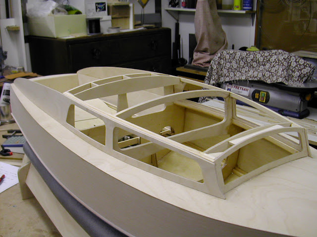

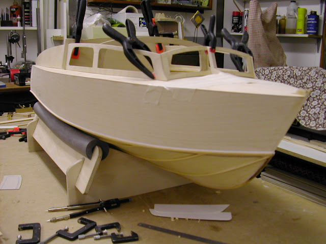

Well finally the sides are on and it now looks like a boat :-)
I've had a good week on it and there is just that cabin top to do then the finishing / fitting out can begin.
PMD - How is yours coming along? Any joy with that cabin roof?  I have decided to cut slots down into the top of the cabin middle former and then laminate the edges of the removable top frame against the inside of the existing edges. With formers at each end and mid way I intend to plank the top surface diagonally with two layers of 1/32 x 1/2in. ply strips. By doing it diagonally it should present an equally rigid edge all round. Hopefully if the masking is adequate it will not stick itself too firmly in situ and prove a total embarrasment!!!
Whatever, we shall see, in the meantime here's the latest progress
Laminating the outer edges of the cabin
Finished result - very strong
At last the second side is on
The fixed area for the windscreen to sit and the 'break' of the removable top
Have to take a break from it for a week or so but back soon with the cabin top and planking the well deck.
Bye for now - Ramon

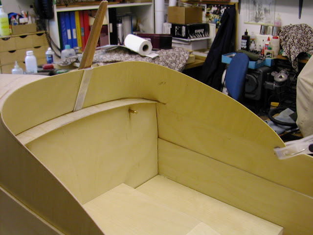

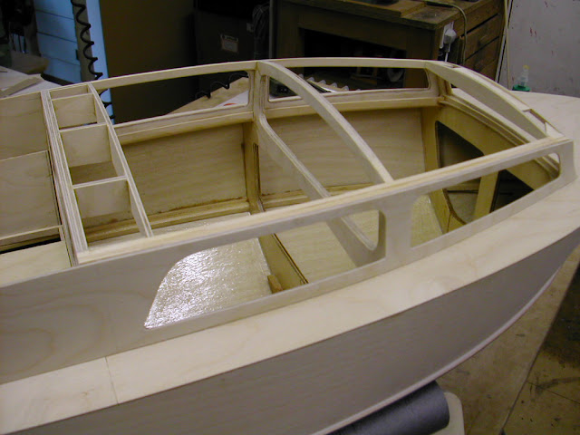

Despite intending to take a break from this I couldn’t stop thinking about tackling that cabin top so everything else that ‘interferes’ has been given the back seat. It has gone much better than anticipated so I hope it will prove of interest
Firstly though, thank you for your kind words Mark, I’m glad you are enjoying the thread. They come as I was beginning to wonder if there was any interest. Lots of viewers I see so I guess if you are that ‘ten percent of ten percent’ there must be at least another hundred of you  ;).
Perhaps I should reiterate what I said at the start - this is my first power boat for thirty odd years and this was to share the build with others. Hopefully to have any errant ways picked up by those far more experienced and also to give encouragement to those who may be considering tackling something similar.

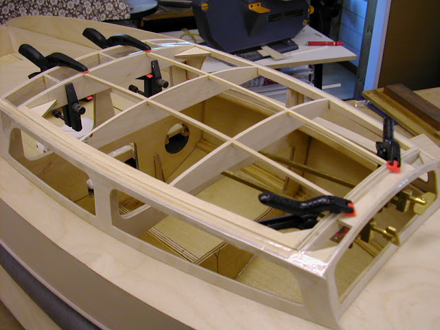

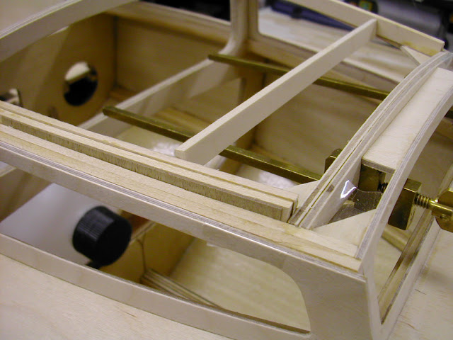

Onto that cabin roof then. Some time back when wondering about how to mould a piece of ply over the compound curves involved FLJ remarked about planking. I felt this would be the best option but immediately thought ‘as an aeromodeller’ and visualized longitudinal planks most of which would have to be tapered.
I was still on this line of thought last week when I was laminating the cabin side rails when I laid a strip of wood over to check the ‘fairing’. Laying it diagonally, the penny dropped and as mentioned it was obious that unlike longitudinal planking it would give the edges equal strength all round.
Though aware of the technique I have never used this method before but any concerns were soon dismissed - I have to say how impressed I am with it and am really pleased with the result  :-)).The adoption of the curves involved, the apparent immense strength and the lack of ‘spring’ as the clamps were removed. Little wonder it was (is?) used in full size construction.

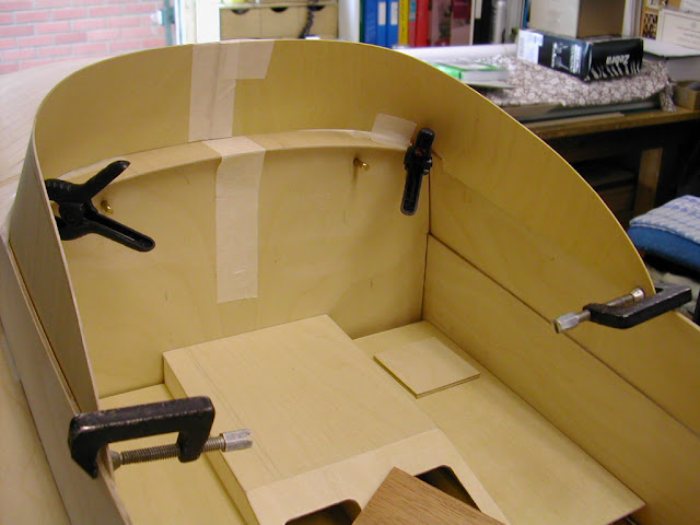

I laminated the support rails inside the cabin top rails with 1/64 ply shims in between, fitted two central formers and two stringers. Once this was set it was faired to the cabin sides then removed. The cabin sides, front and rear edges were then masked using selotape and the frame then replaced using the shims again to keep it in the correct position. Clamped at the rear and forward bulkheads the top was planked with two laminations of 1/2" wide 1/32 ply. It was time consuming but by the same token relatively quick. I used the Titebond 3 glue which gives an incredibly quick grab time for a PVA glue but the limitation was the available clamps!!
Here are a few pics which should explain all.
Laminating the support rails. The ply shim was pushed down before planing fair
Setting the rear frame former
Frame faired and stringers fitted
First layer of planking. Incidentally that coloured clamp - 'Soft' pegs - 2 quid for ten - Tesco's - brilliant!

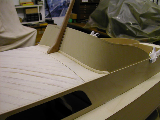

Faired off all round.
A start has been made on finish planking the well deck - more on that later so back soon when thats finished
Regards - Ramon

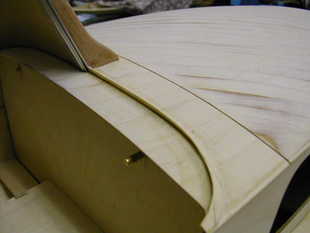

I'm pleased to say that apart from gluing on the fixed part of the cabin roof (I need to sort out the roof catches before I can do that) the major construction is complete :-)
The next stage is the 'fiddly bits' and some basic 'tarting it up' to make it look a bit scale like - handrails, edging strips, cabin door etc then its on to the finishing. I'm hoping to have it in the water by the end of May at the latest but you know the score -- best laid plans and all that.

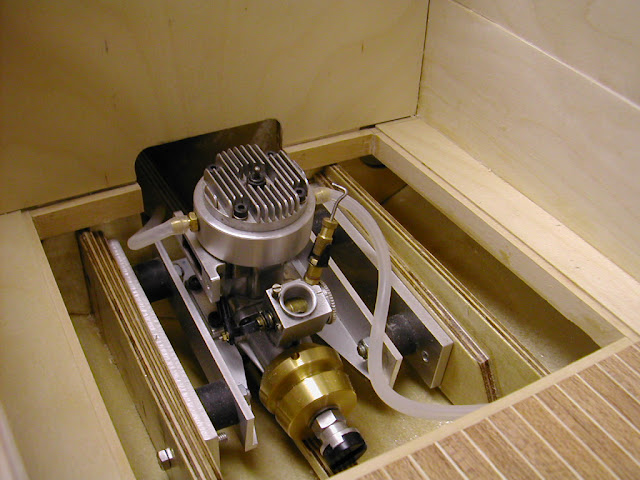

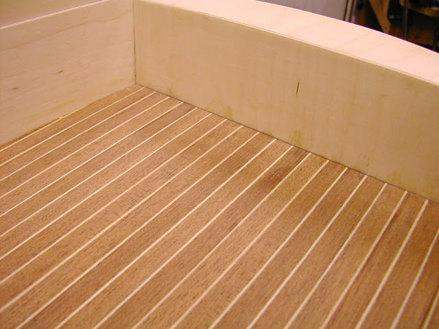

The well deck planking went very well - I used 9mm wide .8 thick mahogany interspersed with 1mm thick lime strips (these were cut from 5mm wide stock to apx 2.5 wide with a scalpel). Using Zap very thin cyano I glued the centre plank down first then, holding the 1mm strip tight against it with the next plank along, cyano was run down the outer edge allowing capilliary action to take it under the plank to 'grab' the lime strip. No 'pullouts' occurred when planing or sanding the strips down which must mean this worked! I did have an awfully cyanoed thumb and forefinger by the time it was done though :D
As can be seen the aft deck slips under the inner transom plate.
The forward half of the well deck is another hatch which covers the engine bay. Again the forward edge of this slips under the 1/16 overlay glued to the main bulkhead, the rear edge laying just over the forward edge of the aft deck
The central cover immediately over the engine is also removable but because this pushes tight against the main bulkhead the hatch cannot lift and is firmly held down. How this will work with the ever present vibration remains to be seen!
The whole hatch is removable to allow access for starting.

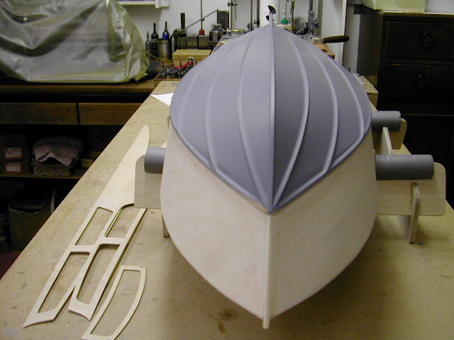

Hi all, holiday soon over, SWIMBO's 'canya' list caught up with, a bit (too much) of gardening catch up and I finally managed to get back onto the boat ;).
I felt that before I could move on the problem of the windscreen attachment needed resolving. First thought was to do this in one piece but having obtained a piece of 2mm acrylic sheet large enough it was obvious that this would be much too thick and difficult to work. Taking a good look at some pics of the full size it appears that the screen was possibly made from four parts - left and right front screen and two side screens. I decided to go for a two piece combining the side screens with each front half joining them behind the short mast. This would mean that readilly available, albeit in A4 size, clear plastic sheet could be used. Searching though the 'Squires' catalogue revealed they do a crystal clear PETG sheet in four thicknesses. I choose 1mm which should be flexible enough for the bending involved but rigid enough for the job in hand. I haven't cut it yet so can't at this stage confirm its suitability but it is cyrstal clear and quite flexible.
To get the shape a cardboard approximation was cut out and trimmed until satisified. This was then transferred to .8mm (1/32) ply with the grain vertical which was then fine trimmed to fit. The central housing was made from ally (though this could easilly be made from three layers of ply) and fitted to the mast previously glued in postion. (This was also bolted from underneath with a 4BA bolt running up into the mast).
As the pics show, using the flexible plywood was a good way of getting the correct shape without having to use the windsreen sheeting. It also allowed the fitting of a beading which the screen pushes against - maybe not quite 'scale' but reasonably asthetic.
Fitting of the initial  ply templates
The final templates and the screen material
Finished and ready to fit the screen proper
Beading and fitting on Stbd side
