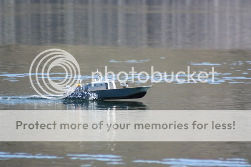

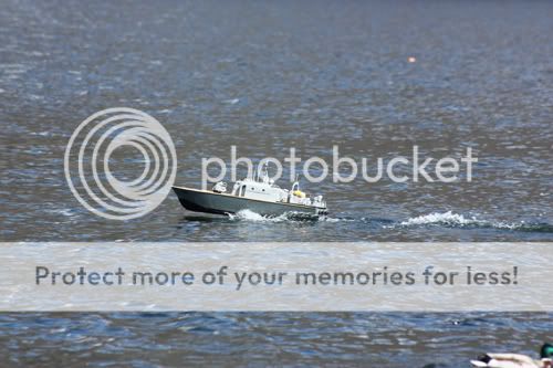

MMB motor in a Perkassa
19.2 v 1/2 throttle

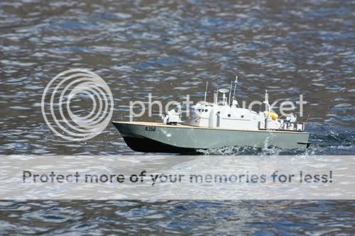

Full Throttle
24v1/throttle ....Not bad on the plane

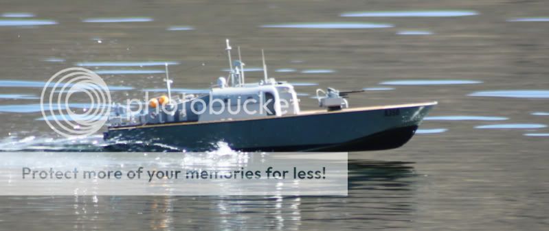

24v 3/4 Throttle Now Begining to move a little

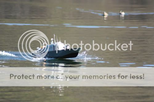

24v Full throttle BALLISTIC MISSILE ran like this for 45mins AWSOME

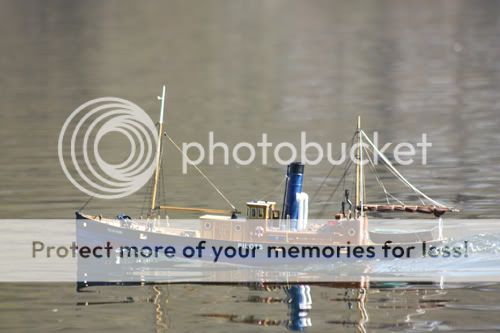

Same motor in a Mountfleet Pilot boat 1/2 throttle could b not get full due to slippage of coupling!!!!!!!!!!!!!! Don't ask.
I have been asked to edit this post to make clear that the coupling that was slipping was NOT an MMB Coupling.
My personal feelings and findings of this Motor is as follows,and by no means what I am about to say is criticism at all they are AWSOME beasts
up to 12v no water cooling needed at all,will swing a 60mm 4 blade prop all day giving you 6hrs+of fun
OVER 12v WATER cooling is needed as they get hot.I today used an Electronise(Sorry FLJ) for test purposes and it overheated numerous times
Running time on 2x9.6v stick packs giving 19.2 volts 45Min's with no probs at all
"""""""""""""""""""2x12v"""""""""""""""""""""24v Volts 55Min's run time BUT IT WAS FLAT OUT me being the hooligan(watch out Wickstead hear I come)

Brilliant testing there Stavros, thats not a perkasa thats a P1 powerboat on 24volts  :-))

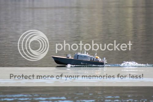

May I point this out that I have allready been certified as a lunatic as I have said in the past THERE IS NEVER A MOTOR FITTED TO A MODEL BOAT THAT IS TOO BIG .........THIS PROVES IT.
Bearing in mind that this is the BIGGEST Perkassa that is sold and is 49ins long and just remember 3 feet of this beast is out of the water!!!!!!!!!!!!!!!!!!!!! Awsome
And specially for Mark a cropped version

Blimey Stav,
It went that fast it blew all the railings off.
Re: MMB Motors rule the Waves at LLanberis
« Reply #16 on: April 13, 2009, 06:41:52 pm »
Ha flippin Ha the joke is that I stripped this down over 12mnths ago to fit twin shafts and never got around to doing so as I oculd not get it to plane on an 850 am I glad I didnt go the route of 2x850's.Hopefully by Wickstead everything will be back on the old girl now she has had a new lease of life
