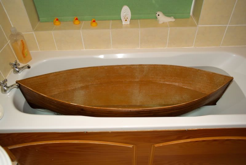

Wifey is at her mums, good time to work out ballast requirements.... 480 fluid ounces has her settling nicely. Yes, this is my winter steam project... :-)
What I shall do in the morning is put a few drops of oil based paint on the temporary "ballast" water ( inside) & that will leave me a datum. It's a Orion Moulding's Scottish Fifie, which is a little larger than I expected... :o

Just one thing to bear in mind with this method is that the hull will tend to find it's own attitude, which may well not be the attitude you want.  Differences in the fibreglass density and distribution as well as the shape of the hull form could well dictate that the hull does not sit at the required level and the water inside will not force it to, all that does is to produce a downwards force at the effective centre of gravity.  Just think if the hull is slightly heavier on one side what is to stop it heeling over  When you then mark it you will be working at a waterline on an angle.
You are really working the wrong way around.  You need to decide at what level you want the hull to sit then make a water line on the outside with pencil and follow that with some lining tape or masking tape.   If the hull is already marked with a recommended water line then use that or take it from the plan if you have one of those. Then you need to put the hull in the bath and add fixed weights to get the hull to sit exactly as you want.  Don't forget the distribution of your steam plant will also play a big part here so it's worth having the big bits to hand before you get too far down the line.  If it sits too low at the back you may then need to add more ballast at the front and if it heels over a couple of degrees you may want to add the ballast a little bit towards the other side.  I would definately not determine your water line from the method you describe because there may be a chance that it doesn't work out when you fit the plant.
I would put the hull in the bath with the water line marked out, put your big steam plant bits in where you want to put them, such as boiler, engine, separator tank, gas tank, bateries, large resin figure etc..etc..  Hopefully by this stage the mode is still too high so you can then add more weights in the required spots to get it to the right level.  Then remove the plant pieces and weight the hull with your added ballast and weight it without to get the required amount of additional ballast.  Some of this could then be fixed in the bottom of the model, say 60-70%, and the remainder kept in hand for when it's finished and you can trim it perfectly with the last few bits and pieces of 'detail' that will make it sit exactly as you want it on the water.

Thank you Bunkerbarge for your good advice. In reality I was just trying to work out roughly the amount of ballast I would need & got a little too clever for myself.. :embarrassed: Steam unit, I have quite decided yet, depends on what is available at a reasonable price ( oxymoron for a good steam engine I know.) I'm scouting e-bay USA/UK & Germany right now & have two Graham Industries TVR1A kits on the way that I will couple if I decide to use them. Not quite decided as yet as there are two Stuarts that take my eye... The boiler I shall make myself, vertical coffee pot is what I am thinking...but that depends on the bureaucracy required for testing/ certification. Haven't really read up on that as yet but I live a few miles from Cheddar so there are minds smarter on the subject than mine living very close... As I may have intimated in a previous post, I'm newly returned to these Isles & have a lot to learn about the changes...

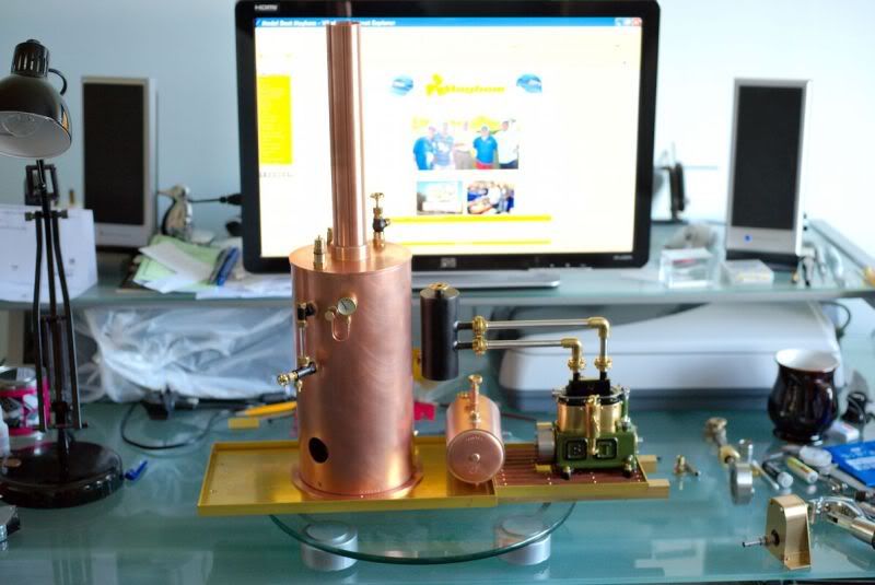

Just getting things laid out, condensate/oil separator/receiver & water tank to come. I've finished my boiler feedwater pump ( my own design) so need to plan where that goes....
