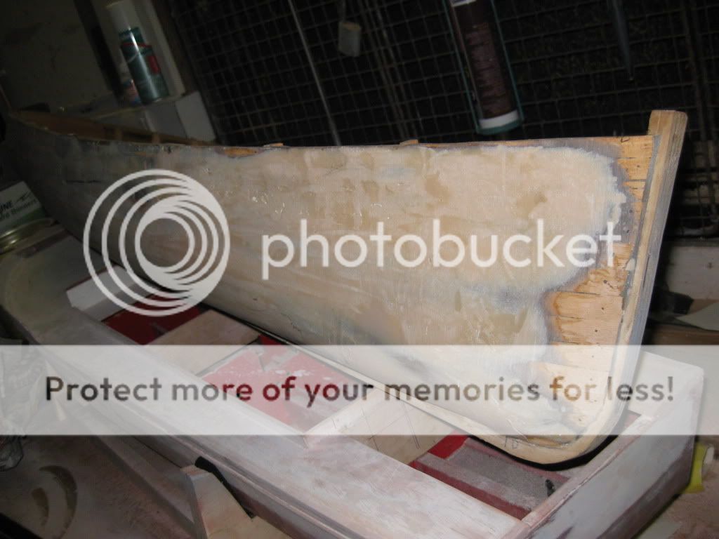

After a long period of being laid up due to other commitments I've had some time to get some more work done on the picket boat.
I decidied a long time ago that a plywood stem was really not what I wanted to be seen on the boat, and that really an oak one to match the transom was the ideal. I took the step of planing the stem back to the rabbet, fitting a new stem of some nice seasoned oak and carving and planing it to shape.
After I had epoxied it in and made sure the steam and apron were well and truly bonded I set to and started attacking (true description) the massive lump of unshaped, unfinished and downright unsightly GRP splodge around the apron. It had, I amagine, a two fold purpose in the builder's eyes; strengthening the plank ends and a poor attempt at making sure no water ingressed from the plank ends- it's lucky that water hadn't got behind and rotted the planks. Perhaps the builder should have had more confidence in his planking to start with as there are no signs of ingress.
In the process of removing said horrible lump a couple of the planks loosened below the waterline, so I have stripped the worst back to the first layer of planking, and the second just cut ready for butt jointing a new section in.
I have decided I would like a couple of intermidiate frames at the bow as there are so many turns in the planking and I wanted something to secure the replacement planking sections onto. I first made templates in paper and ply before making the finished article in Iroko. It is fastened on every other plank with brass pins and epxoied into place. There is a mirror piece to be made for the port side too.
Once they are in, the breasthook that I made, but haven't photo'd will be installed.
It's nice to get back to this model, so hopefully there will be many more updates in the coming weeks!
