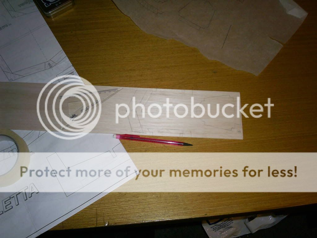

Hello all,
Today I started tracing out the components for the Ray Wood freelance cabin cruiser 'Margoletta' (Model Boats June 2005). Thanks to Dougal99 for sending me the build notes.
The plans show 400 size electric power but as I'm getting more into model engineering the jury is still out on what I'll use for power.
Pics promised as soon as there is something to photograph.
Rockets.

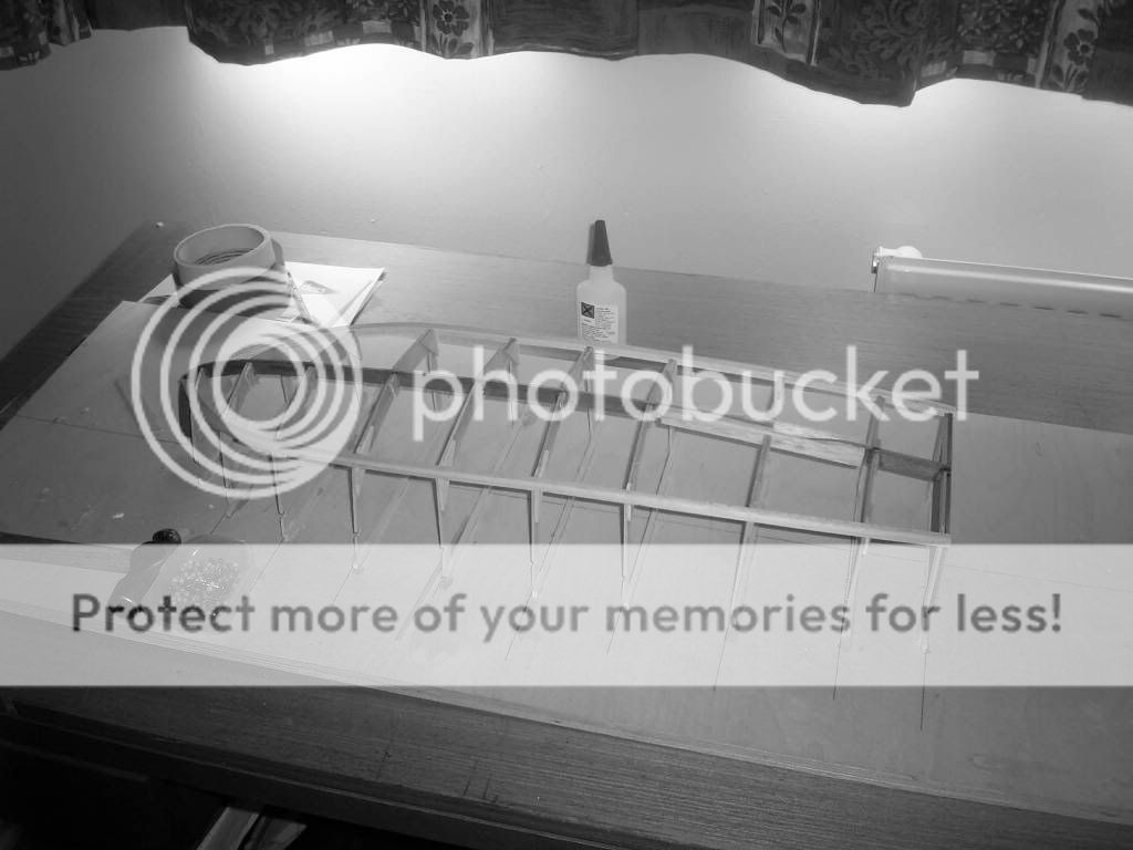

« Reply #16 on: April 25, 2010, 08:45:58 pm »
Done a little bit more....
The keel is made from some very nice mahogany ply that I got free. I have made the transom from the same material, should look nice varnished up. It is wise to stay well in with the station carpenters!
I will be doing a bit more this coming week hopefully. Thanks to Peter Fitness for the top help he has given me.

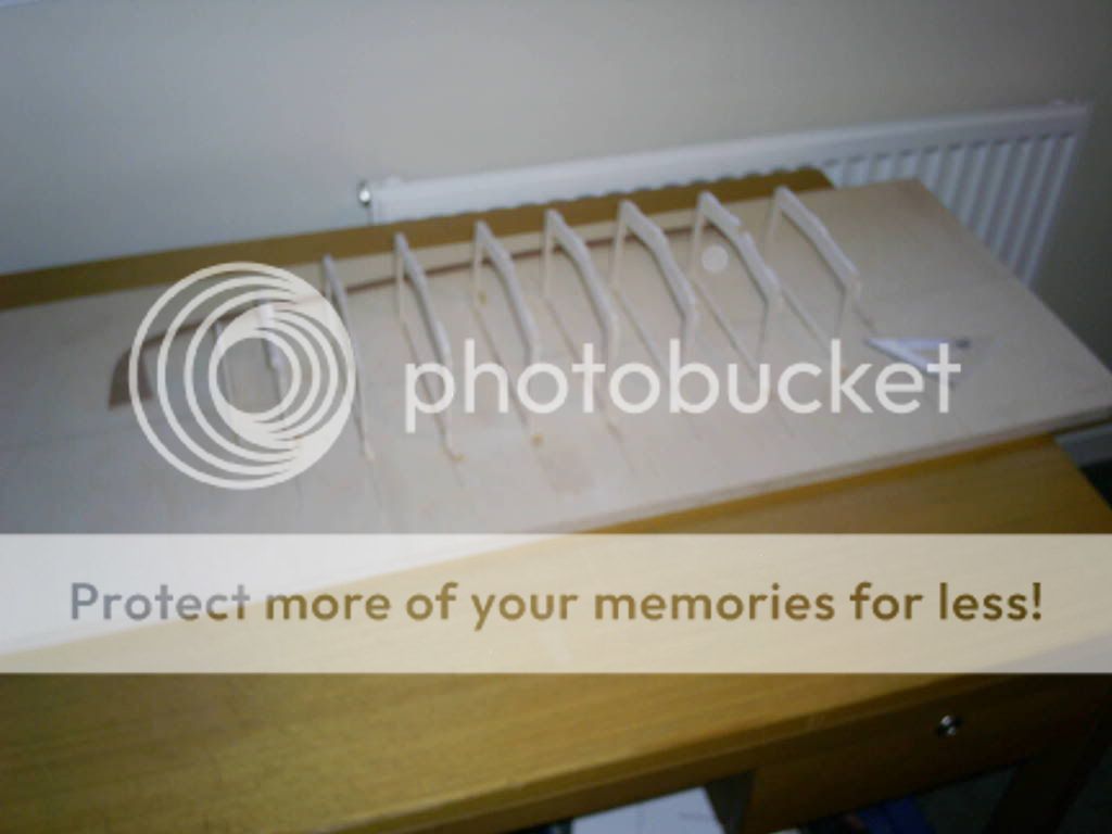

« Reply #17 on: May 31, 2010, 06:04:57 pm »
Little bit more progress, still plenty to do.
Rockets
