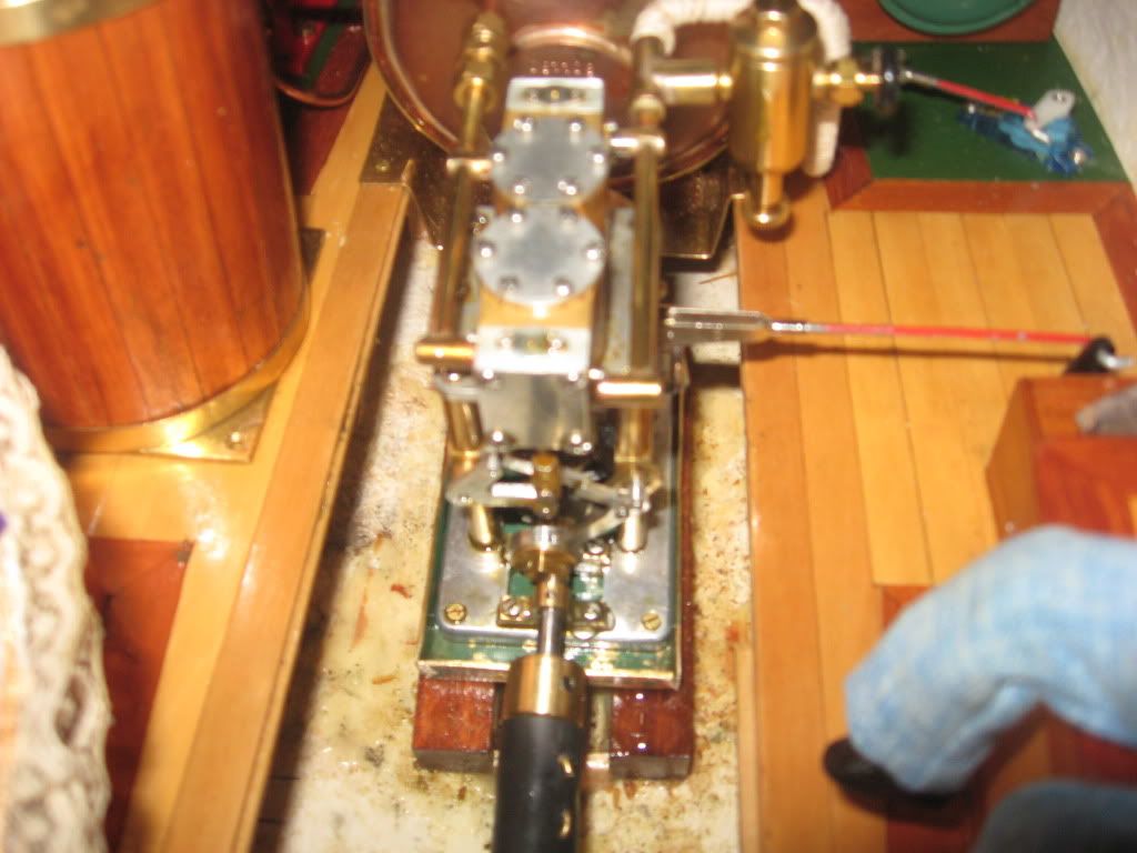

I mounted my boiler and engine separately, old habits die hard, I didn't want the boiler at an angle, and the angle of the propshaft was too much to use a coupling, I like to keep the coupling as straight as possible, so I fitted hard wood engine bearers. I have an idea now to purchase a 1.5mm plate and bend it so that the engine and boiler can be mounted as one, and removed as one. It is possible, just have to be accurate with my plate bending.

All mine are mounted on full engine beds, held into the wooden hulls by bolts, as Gerald (steamboatmodel) much easier to clean, service and maintain
Here is an example of a few.   :-))

very Nice Mr Steamboat,  ok who do you get to polish them, must cost that £20 note of yours a month on polish alone.
: benjaml1 the main thing is to get the boiler as low in the hull as possible and a good mount, you have to remember the weight of it IF it was floating about. even just the trip in the car.
the engine can be lifted on blocks , I had to do this with my tug to keep the boiler low but bring the engine up to the shaft, but whatever way you do it make it easy to remove.
