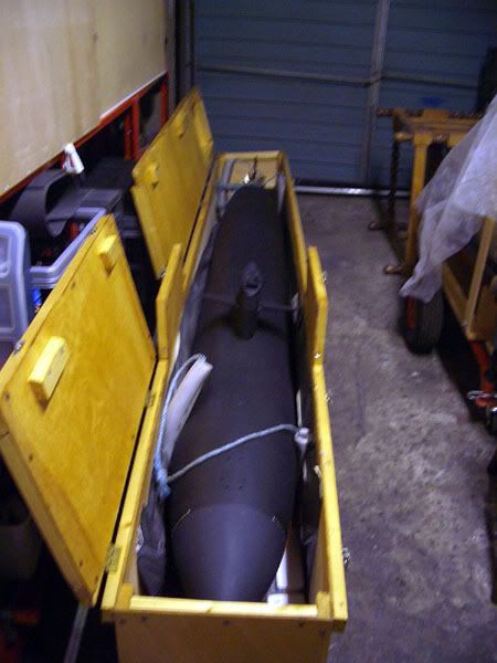

I have also managed to acquire a big'un today - an Eden Los Angeles complete with torpedo system. Absolutely beautiful! 103" loa x 9" beam. Pictures to follow when I can find some trestles and get some help to lift it from its 'coffin'!
Andrew

ajg141
  • Posts: 90
  • Location: Edinburgh
Re: Alpha Build
« Reply #24 on: February 17, 2007, 10:16:45 pm »
Still in its crate at this point. Once I get the lifting team pressganged sometime next week  I'll get it up onto trestles and get some decent pics.
Andrew
