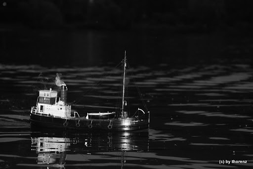

« Reply #60 on: July 07, 2010, 10:54:04 pm »
Model ship meeting 02. - 04.07.2010 Edersee Germany / Hessen
A few black white Impressions from the buffer
