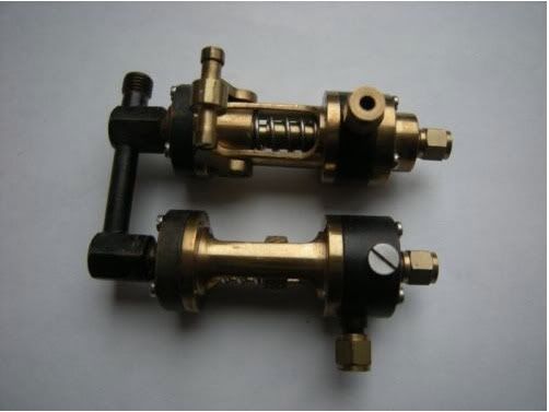

Hello KBIO,
thank you for the help so far, yet valves diagrams and illustrations will strongly support your explaination, as there are three connection points for each valve!
I have bought these valves on ebay, darn expensive, yet still worth the price, and without instruction sheet.
<a href="http://s1017.photobucket.com/albums/af294/STEAMPROPULSION/?action=view&amp;current=anton_valves-1.jpg" target="_blank"><img src="http://i1017.photobucket.com/albums/af294/STEAMPROPULSION/anton_valves-1.jpg" border="0" alt="ANTON GAS VALVES">[/url]

Hello Mog8! :-)
I'll see tomorrow if I can get the original drawing and send copy to you.
What I can say is:
a)- on the left of the photo, the two items are linked together and receive the boiler pressure.
-b)(I need confirmation as I am not sure but) on the right side of both, you need to link the two ends together.
The gaz enters top/right. It comes out on the right and goes right side of the second item (regulator) , then it comes out on top side towards the burner.
I understand, it is a bit confusing , but I won't let you down and I come back tomorrow w/ everything! ok2

Hello Mog8! :-)
What I can say is:
-b)(I need confirmation as I am not sure but) on the right side of both, you need to link the two side ports together.
