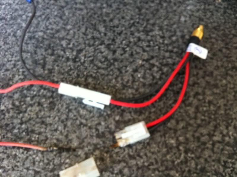

Any Microcat users out there had any issues with the battery chargers??? I have just purchased a Microcat which came with a few accessories, including the adaptor that enables you to charge both batteries out of the boat. I have charged two sets of batts in this way over the last 24hrs, however, I have just gone to charge my third set and within 20secs of plugging them in, the leads started to smoke and before I could unplug the charger and unplug the batt leads, they had set on fire.
Thanks goodness it was only 20secs before it happened. If it had been a minute or two before anything went wrong, my wife, baby and I would have left the house. God knows how that would have turned out.

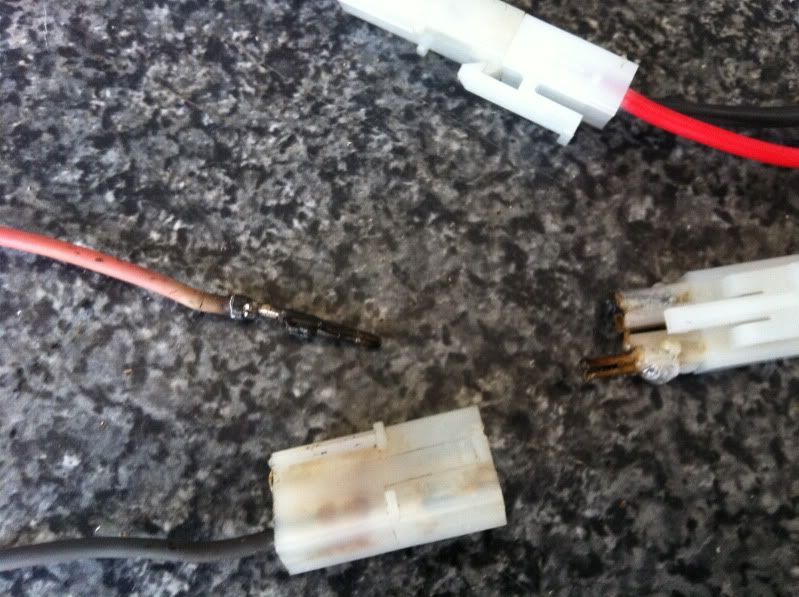

It looks as if there was a bad connection in that Tamiya connector - was there some corrosion inside it? I don't think it was the battery or charger.

I doubt corrosion may have been the cause in new wiring, old possibly, perhaps if the current is arcing to complete the circuit maybe broken strands, hard to tell now since the damage is done, very little evidence to the untrained eye.
Only thing that occurs to as to why.. would be the connector or the wires around the wrong way creating a short that level of burning in only one section would be the sparks or heat build up in the cable/connector with such force, with a constant supply of 300mha-500mha for 20's is enough to cause such a problem, however if that was the case i'm surprised your charger didn't blow the fuse or trip the main house fuses.

Ray in the first picture is the charger wire on the left hand side ? and the wire on the right yours to the batteries

No mate, other way round.  The charger plugs into the gold phono socket on the right of the picture and the two batteries plug into the 2 tamiya connectors on the left (well, they did),

Looking closely at the pictures, the villain of the piece was the connector.  Apart from where the wire is very close to the connector, the wire looks OK, only the connector has suffered, so its a good bet it was either a poor metal to metal contact within the connector, or a bad bit of wire adjacent to it.  Either way, if the charger could only deliver 500mA, that is not enough to do that kind of damage.

The way that plug has burnt and the time it took it is definitely battery current (IE dead short) that has gone through the connector, I almost wonder weather for what ever reason that particular battery was plugged revere polarity from the others( long shot I know) or the gold connector somehow shorted ? in between charging sets of batteries.
Yes change the connectors, the Tamiya (molex) are notoriously bad for high contact resistance. The Deans style are the most common and reliable for general purpose modeling power :-)
