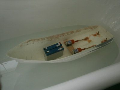

Finally some progress!! Running gear is mainly installed in the hull now and I'm proud to say that I am the owner of a floaty boat having given it a quick test in the bath (professonal test tank  ;)  )to check for any leaks. The bow thruster isn't in yet and I've made the battery box out of thick plastic sheet.

I've noticed the images to be different sizes, its only because I always forget what size to resize them on photo-bucket  :embarrassed:
I also forgot to say that its a really stable boat (at least it is in the bath when I was rocking it about) and with the bow-thruster in it should be pretty nifty across our local lake :-) . I'm quite pleased with how its coming along now :-)
