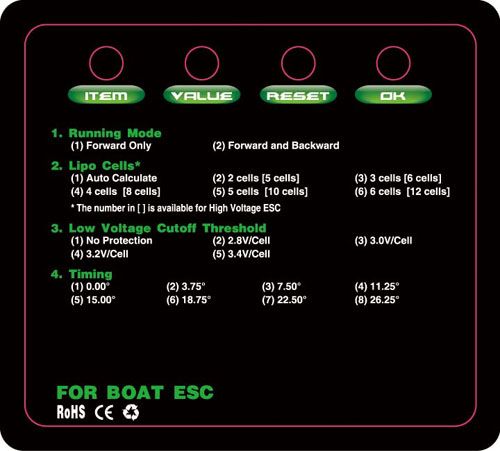

You might want to hang on to the programmer if your going to try boats with brushless you can use it for the Turnigy marine esc's by printing out a new faceplate. They do have great power for their size I have a little outrunner in a boat that really flies, but don't run it too much without a load, it's not very good for them.

It already has a new full featured faceplate with the v2 software

You can use this faceplate on it for the marine esc's.
