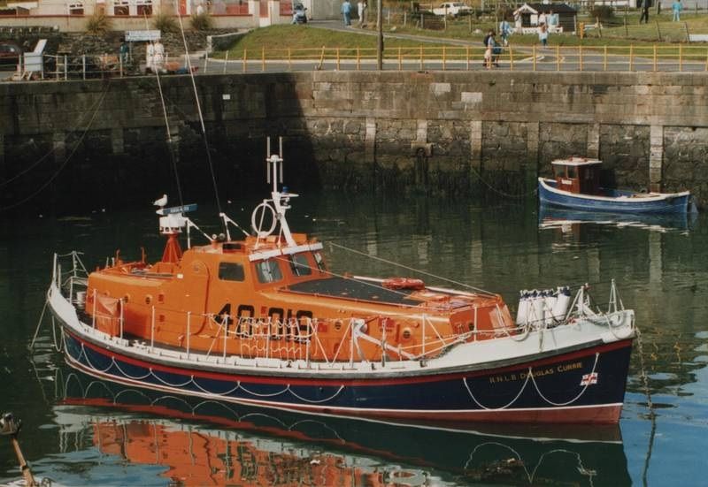

If you're just doing a renovation of the boat then i would recommend only building it as one of the last three boats, Lady MacRobert (Montrose), Hugh William Viscount Gough (Stornoway) or Douglas Currie (which went everywhere) because the Aerokit is based on a Mk 2 Solent which had a different supertructure to the earlier boats. If you want to build it as the Bembridge (IoW) boat then you'll need to build a new superstructure with sliding doors as opposed to watertight doors.
Douglas Currie, a Mk 2 with the wheelhouse further forward and a fixed mast
Three Sisters, the last Mk 1 with the wheelhouse aft and a folding mast.
There are plenty of photos of Douglas Currie on the net, because after service her owners have kept her pretty much original.

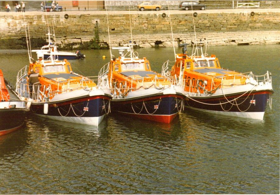

The mast depends on the boat you're building. As far as I found when I built (partially) my solent, there are three different masts. This photo has all three.
The boat on the left (I don't know which one it is) has the mast they had when they were built to go afloat, because it can't fold. This had an angled section going up to a crossbar, which has two braces fixed to it's ends. Above this is a vertical piece which has what I think is the HF aerial on it.
Douglas Currie
The boat in the centre has a folding mast - this doesn't have the vertical piece, and the braces bolt to the main upright. The HF aerial is at each end of the crossbar.
Three Sisters
The boat on the right has a mix of the two - possibly because it was put into reserve after serving at a slipway station, I don't know. This is essentially the folding mast with the braces fixing to the ends of the crossbeams.

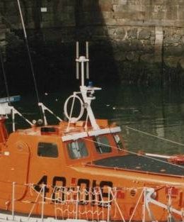

As with the DF loop, from the photos I've got the slipway boats had a single, hinged loop that folds flat to the wheelhouse roof, while the afloat boats (with the fixed masts) had a fixed twin loop.

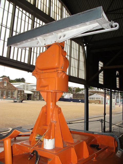

The radar varied for each boat. The actual mast is always orange but the unit itself is either white or grey. Some boats had a box under the scanner, which was either white or orange
North Foreland, a Watson but the radar was standard

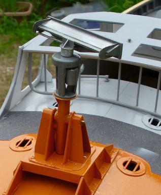

I think most of the boats had this radar though, which was more often than not dark grey
This appears on lots of different types of boats, but in the photo of the three solents the centre and right boats have it.

The blue beacon isn't on the wheelhouse roof, it's on the top / top platform of the mast (you can see it on the photo with the three boats)

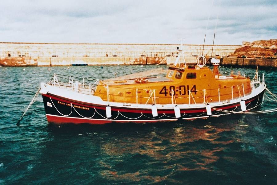

This is the only photo I could find. There are probably more, but this has the answers to most of your questions.
Lady MacRobert on relief at Dunbar. She has the tall mast, box radar, twin DF loop and interestingly black wiper boxes.
