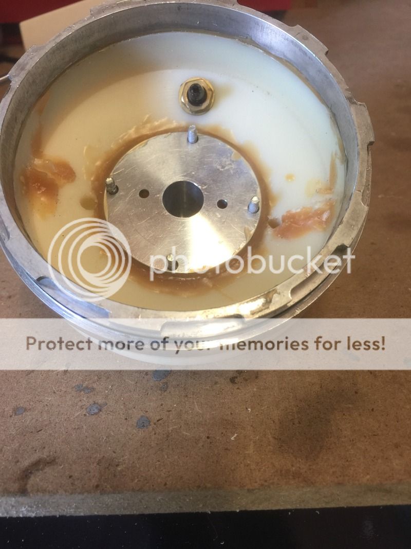

The old propshaft outlet was opened up to acommodate an Engel Motor mount
I bonded a couple of M3 screws to the mount then bonded the mount to the endcap
I do still need to run some more Stabilit Express round the outside of the propshaft mount thing, a bit of belt and braces.

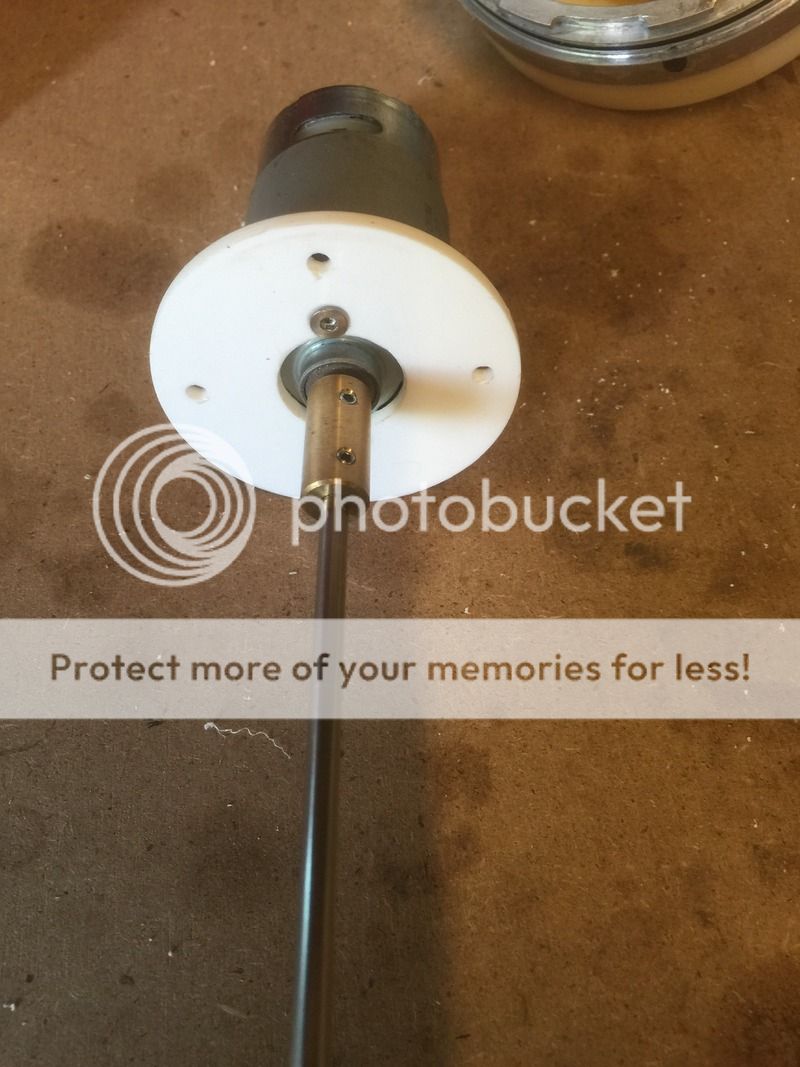

A motor mount was then fabricated from plastic and screwed to the motor
The motor then fits to the endcap with 4 nuts.

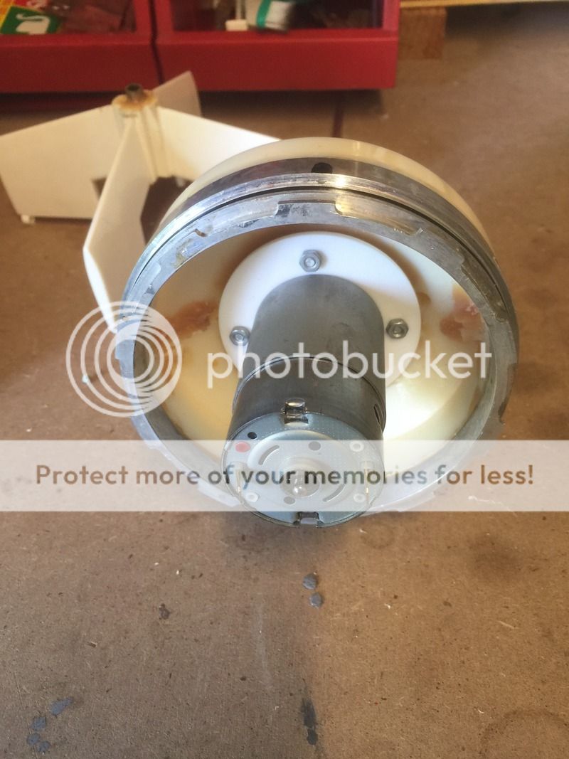

Test fitting the tail section
I need to glue the prop shaft support tube into the plastic support.  The Kit design had an integrated propshaft/gearbox/motor mount that I manage to break and replacements are stupidly expensive.
Once this is all glued/screwed together I will decide if further reinforcement in needed
