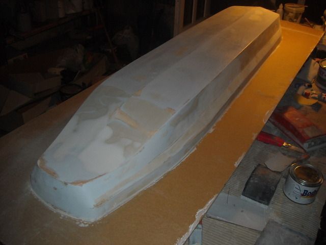

Some more pictures of the progres! It was covered with tisue and resin and after it was cured the filling and sanding busines started. Then it was sprayed with two pack automotive filler.

Some more progress since the last post! It was sanded to a smooth finish with a wet and dry sand paper and I started waxing it with a good quality release agent! Here is some pictures!
