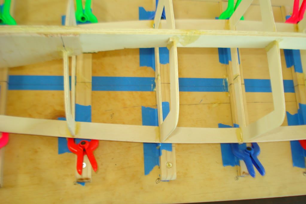

 i am  attempting to build the DUMAS Tuner Clipper  my progress so far with pic
DUMAS KIT not very fancy
cutting the keel in half to fit the stuffing box
lining up the frames on the board
fitting the deck shelf
fitting the pullpit deck and marking out the pice i decided to remove from the for foot to give the elision of more rake in the stem
