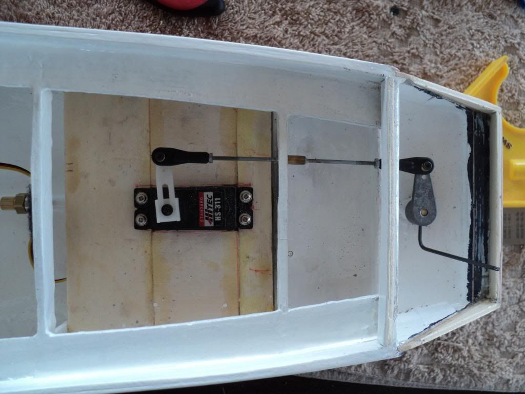

need advice how to get more rudder
« on: March 07, 2013, 04:31:39 am »
hi guys
i have the steering arm sorted i got rid of the clevis and went to ball joints all good now no binding
BUT i would like more rudder for slow maneuvering  i have the the servo set in the center and the rudder amidships i get the same amount of rudder port and starboard
i tried shortening the tiller arm about 3mm with some holes closer to the boss  but the servo seams to bind up and i cant lengthen the sevo arm as its at its max
the rudder is free to turn to 90deg eather way when not conected to the sevo
some pic of the in stall

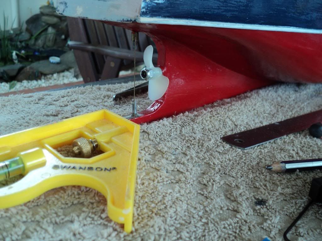

 im getting about 45 deg see yellow square under the boat  [size=78%]ing

Sounds like you are getting plenty of throw already.
More than the ship can really use without acting more like a speed brake.
Try a different rudder design.
Perhaps a simple Fishtail rudder with a triangle or square(diamond) bar on the trailing edge.
Or for a bit more complexity, use a Becker Rudder.
Then the servo and rudder throw can remain within the area of non binding movement, and
the trailing edge will give the prop wash a larger diversion.

...I tried shortening the tiller arm about 3mm with some holes closer to the boss  but the servo seams to bind up and I cant lengthen the sevo arm as its at its max.....
From a non scale guy but if that is a fixed bushing aren't you putting a lot of bend in the control rod when applying max rudder? This in itself will cause binding problems I would have thought.
I would slot the bulkhead and seal with a rubber gaiter for a start.

Agreeing with Umi- san, soldering a strip across the back edge of a rudder creates a Fowler flap effect, should increase rudder effectiveness.
The prop' you have fitted in the picture seems a strange choice, for the kind of hull shown I would go with a very shallow pitch 3 bladed prop, the shallow pitch alleviating some of the paddle wheel effect suffered when in reverse.
Is your speed controller set up properly? Some ESC's have auto set-up but can be set up or reprogrammed to give smoother control over stick range.

the prop in the above pic is the one that came in the KIT , i hated it so put this one on  but it is to fast in a confined space with the steering control i have at the moment ,

the control rod does NOT touch the bulk head as it is notched to clear at full lock both ways ( my be i took the pic before i did that )

The pictured brass propellor still seems quite a high pitch, could you let us have more info on motor type, which Viper ESC you have and voltage you're running everything at?

If you want more rudder throw but the servo binds up....
Are the black fittings on the end of the pushrod the type that go both sides of the servo arm / tiller arm? If they are there is only a limited amount of travel before the servo arm will hit the bottom of the slot that goes over the arm.
Hard to explain but a ball joint sitting on top of the servo arm with a push on cup will allow a full 360 degree rotation but the links you have at the moment will be limited to 250 odd degrees before the arm hits the fitting.
Maybe look at ball joints and cups from radio controlled cars to give a larger range of travel. The rudder looks good on the kit so be a shame to add something out of scale.
Craig.

the fittings i have are ball joints they sit on a half round on top of the tiller arm same as the ones on your car there about 3 mm clearance between the rod and the ball joint
you can rotate them 360 deg ( if you disconnect one end of coarse ) they are not clevises i had them on and they did lock up [/quote]

I hope I'm not stating the obvious, but rudder authority is gained in only one sure way: by increasing the volume and force of water it deflects.
I suggest trying this simple experiment:
Cut a piece of thin but stiff plastic, such as an old hotel key card, and tape it to the rudder, so that the rudder is longer, fore and aft. The idea is to increase the area of the rudder that is in the thrust wash of the prop. Then see if your turning radius decreases. If it does, it indicates that with the current setup, you simply aren't getting enough thrust against the rudder to produce the sort of rudder authority you need.
Simple ways to increase rudder authority of a barn-door-type rudder:
  • First remove any flex in the linkage. If the linkage isn't stiff, the rudder will not deflect all of the prop wash striking it.
  • Increase the amount of rudder deflection. You've done that. 45 degrees is about the maximum for effectiveness at slow speeds.
  • Increase the volume of the prop wash striking the rudder by (a) increasing the blade area (larger prop, or more blades), or (b) increasing the RPM of the prop, or (c) decreasing the pitch of the prop, which moves more water per revolution, or (d) increasing the rudder area, or (e) some combination of the above.
Good luck!
