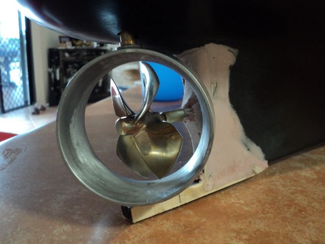

ok here is some pic of the nozzel fitted
prop shop nozzle / prop
fits nice but any bigger and it would start to be a pain
still molding IN THE STERN POST  GOING TO BRING THE BOG ALONG THE SHAFT TUBE TO REINFORCE IT
50 YEARS OF TOWING NETS

Old Shrimper,
What motor; gearbox reduction, are you having with this kort?
Glyn
old shrimper
  • Posts: 297
  • Location: FNQ AUSTRALIA
Re: whats the BIGGEST steering nozzle for the AMSTERDAM ?
« Reply #47 on: May 18, 2013, 09:48:03 pm »
hi glyn
it will be hi torque 770 low rpm  with no gearbox
