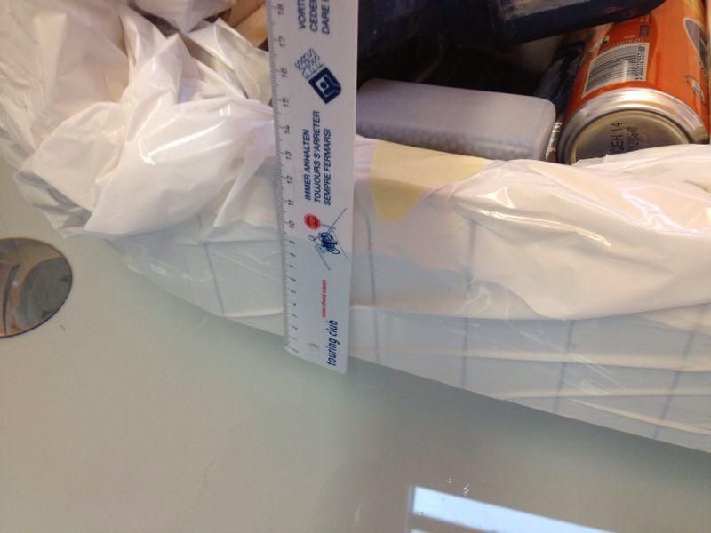

Time to test the unfinished CM in the bathtub!!! Hull safely covered in a plastic sheet and wow!!!!! It floats totally stable!!!!! Unfinished hull weight is 4.8kgs.
Picture shows hull in water with 10 + 4.8 = 14.8kgs. Nearly 5cms in the water. not enough! Waterline is aroud 10cm.
Ok more weight ---> 10kgs (cans/bottles) added till 9.5cm are reached ...
I couldn't add more wiehgt ... hull got instable because of high point of CG. I must say that with the right weight added the CM will be as stable as the original CM!
The total weight for the test was over 25kgs! It need another 3-4kgs to reach the right waterline. Now I have to get a lot of scrap iron to fill all avaiable space with it ...
Danielle
Hi Danielle,
Congrats on thinking of a novel way of test floating the CM and inventing a new accessory for pool parties at the same time ! In case the lack of stability should affect your plans (Though I wouldn't think so ) the greater part of that loss was due to using cans/ bottles of liquid, each of which were not 100% full. This slack 'water' causes a thing called 'free surface effect' which decreases the stability markedly. If you think of the difficulty of carrying a washbowl full of water because the contents slosh about, this is in effect what is happening in every can etc.
After that useless bit of information ! Enjoying following the progress of your excellent model. Thanks !
