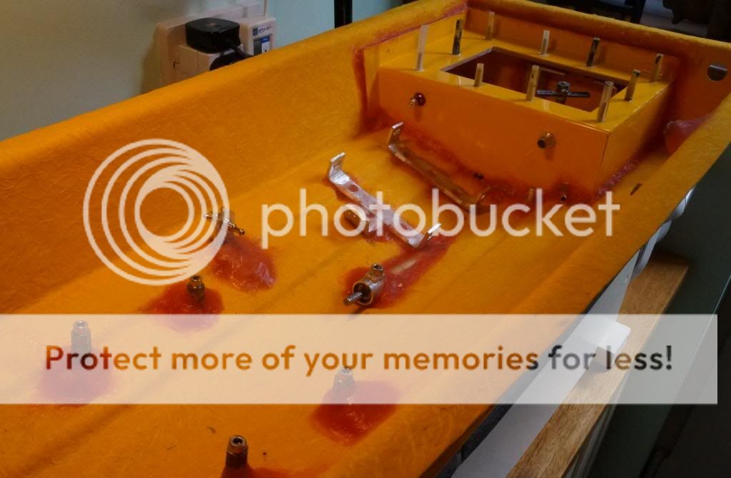

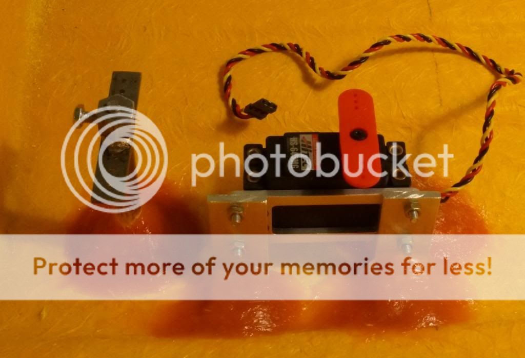

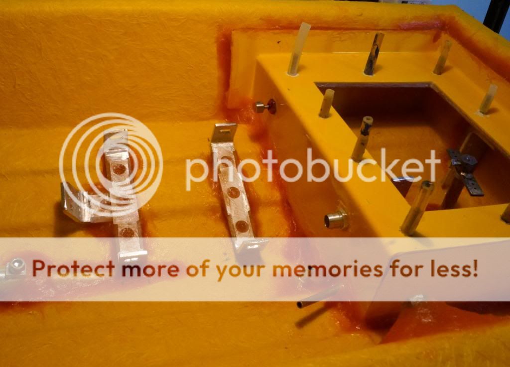

Rudder servo mount in place:
Servo vertical alloy brackets to take the clamp mounts:
Water pick up externally:
Forget all insults, always remember compliments.
craig dickson
  • Posts: 335
  • Location: Brigg North Lincolnshire United Kingdom
Re: New Build for BMPRS racing A-Class
« Reply #2 on: April 09, 2013, 06:28:17 pm »

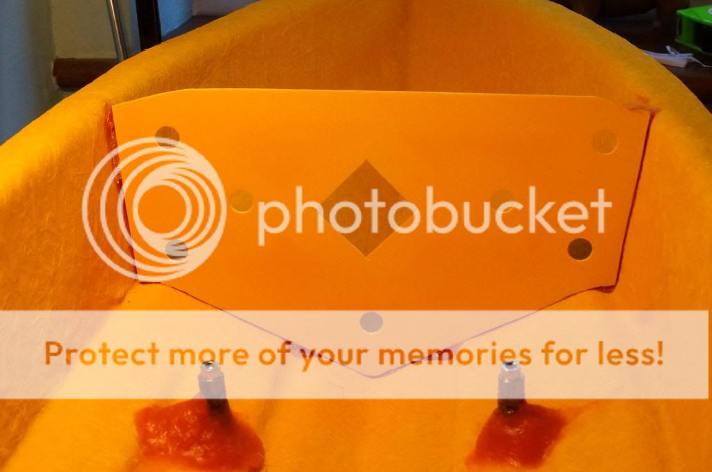

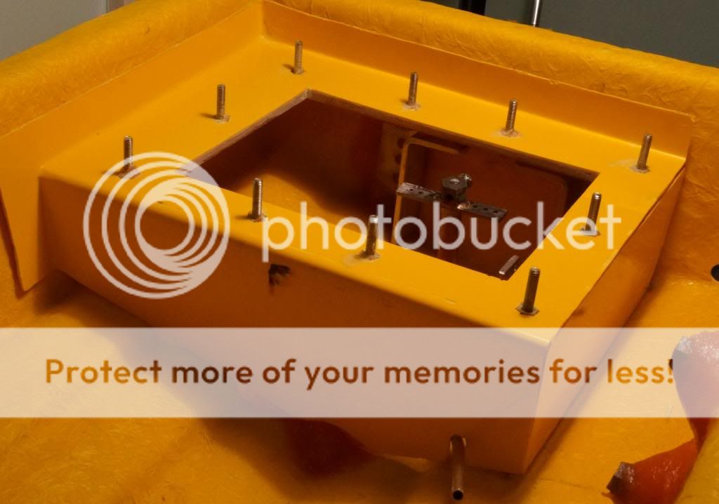

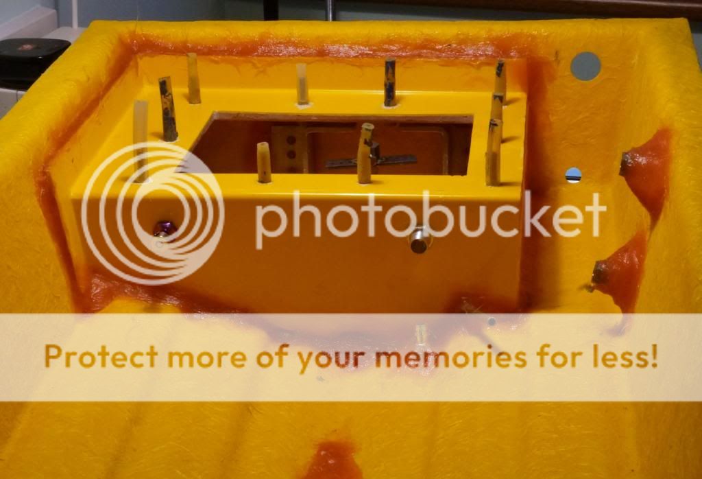

Battery pack suround. To take a 5 cell pack wrapped in foam secured with plastic ties:
Radio box surround:
Internal reinforcement of radio box flange for lid:

Access hole cut out:
Dry fit of radio box:
Box fitted in pre-fibreglass tape:

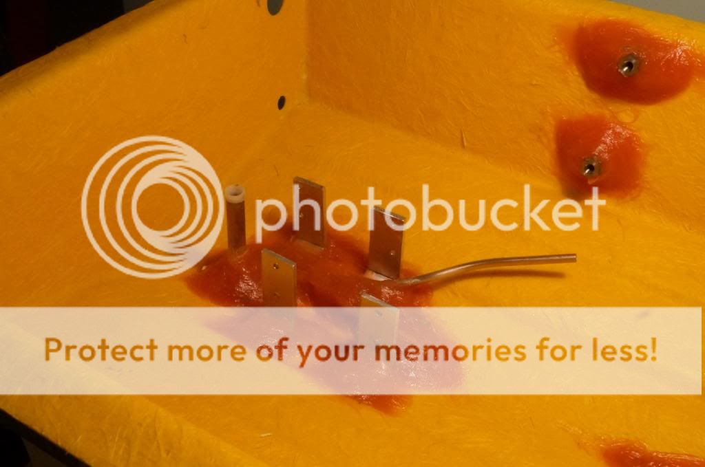

Those importat pilots of the boat.....
Alloy fuel tank cradle:
Tank in place:

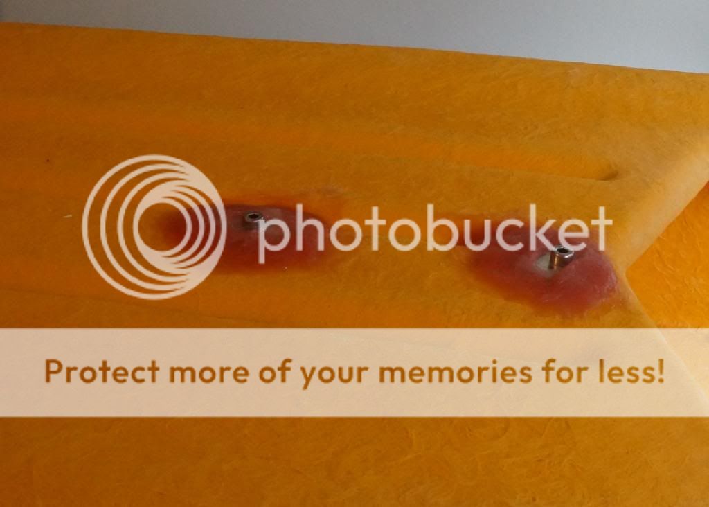

Front grab handle:
Grab handle mounts (alloy backing plates fitted underneath the deck for strength):

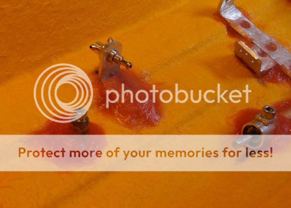

Dubro fuel filler valve and mount bracket:
Iternal fittings:

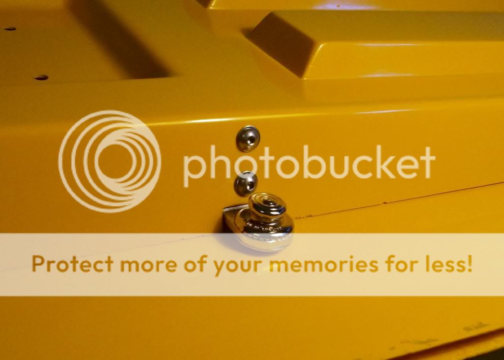

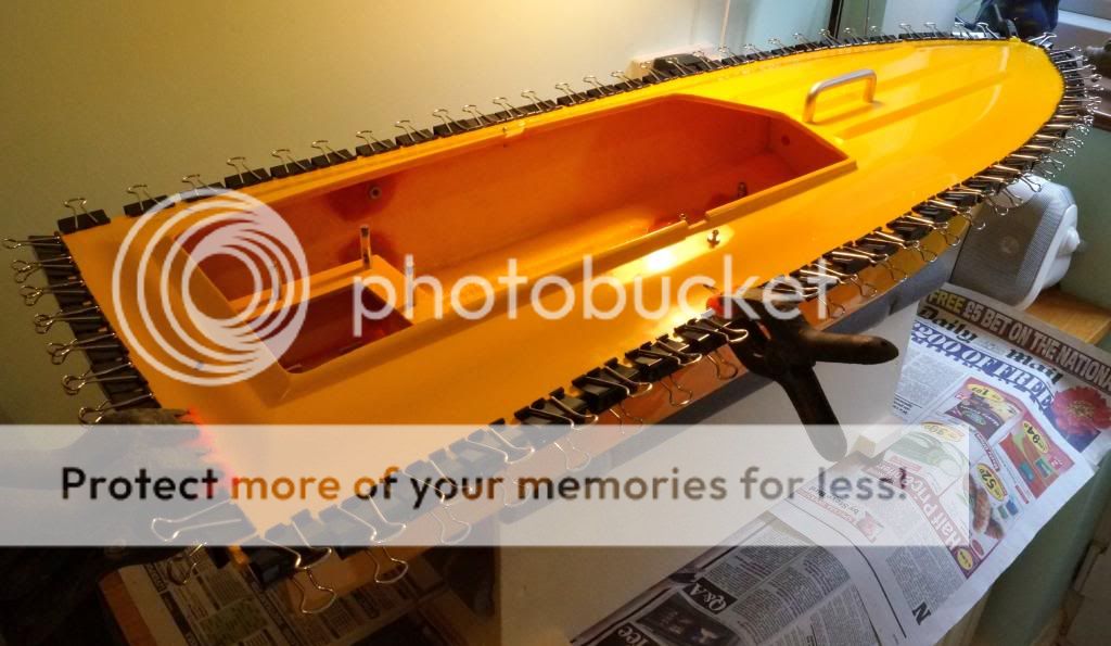

Top hatch retaining brackets and quick release clips (one each side):
Front bulkhead (with vent holes for expanding foam to be added):
Hull and deck joined with plenty of clips:

Hi Craig, I like the use of the MG hood fastener you are using to hold the lid on, very clever too. You are doing a very nice build, thanks for sharing.  Mick B.

Mick, the clips that hold the deck on came from Prestwich Model Centre. I didn' know they were MG clips. All I did was use some 3mm thick alloy plate bent and drilled to hold the clip horizontal.

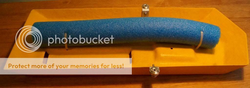

Should we bother with hatch flotation devices?
I decided to attach  some flotation to this hatch on the basis of if it comes away from the boat I will be able to retrieve it. Also if the boat flips and the hatch remains attached (as I hope it will) the foam will give extra buoyancy to the boat.
I opted for plastic securing ties  for minimal weight and with them being a neutral colour they are hardly noticeable when viewed from outside the hatch.
Craig

craig
why didnt you fibreglass 2 small strips of metal in slightly arched so you could pass the cable tie through and then you wouldnt have had to make any holes !
the boat looks great at weekend too m8 cant wait to see it on the water  :-)) :-)) :-)) :-)) :-))

Just silicone some poole noodle to it,doesnt need that much to be honest.
Mart

craig
mark
Hi
The way you suggested I agree would have been neater. The main reason for not doing this was that because this hull has a lot of freeboard I wanted absolute minimal weight above deck level to maximise stability. And the "clear" coloured plastic ties are actually hardly noticeable in respect of the small section showing above the hatch. That should be evident later when I photograph the finished boat.
Silicone would have been an alternative option and probably just as effective I agree.
Craig :-)

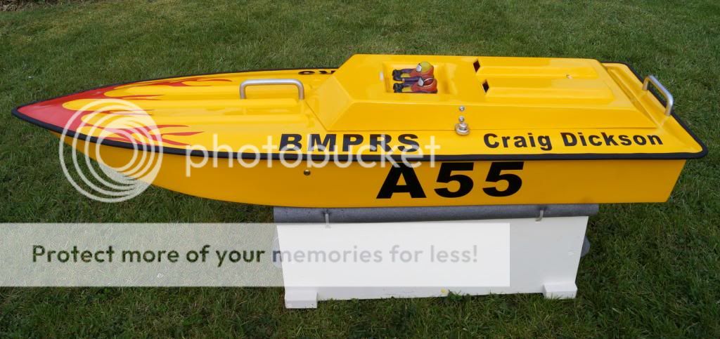

The boat now race ready and finished:
And the internals:
