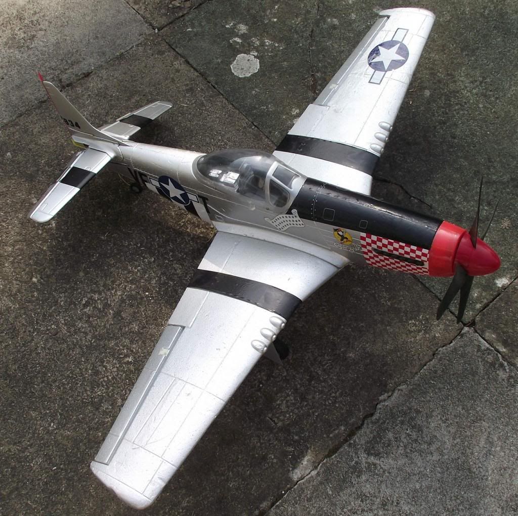

Hi All, I was given an art tech P-51 mustang today - Can anyone possibly direct me to some instructions for it and any spares please. It has a broken tail plane that I would like to try replace, perhaps someone has a crashed one with an intact tail plane??
I tried the 11.1 lipo that came with it but although it powers the servos, the motor will not run, the battery may be "xxxxx" as it has a squishyness to it, as if the cell packets are filled with air. I am going to look out for another anyway.
Would love to get in touch with anyone who has one of these and can offer any tips etc.
If i cannot get it working at least i will have a brushless motor and some servos for a boat!!
Wayne
