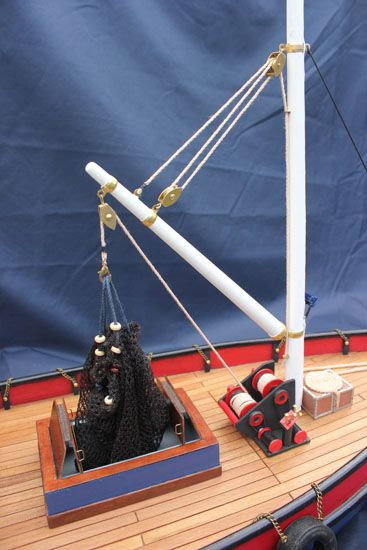

Day 54 Finished installing the lighting made wiring looms all tucked away neat and tidy fitted and painted the mast and jib with all its rigging fittings all from the parts box.. scratching head on pulley blocks as I can not get any to the size I want anywhere in the uk., but I have a plan :}
15mm and 8mm plumbing Olives with screw end of small latches cut of and soldered on for eyelets
Don't chuck it out turn it into something

« Reply #55 on: August 19, 2013, 12:41:42 pm »
Late on Day 54 O[/size]k so as you might of realised by now I like making my own parts so them pesky pulley blocks I was looking for all over the internet I no longer need to do as I will make my own.. from the good old fittings box this is what I came up with size 18mm x 12mm approx.. the pulley wheel is material eyelets from a craft shop. made two single blocks and will make a double block tomorrow.. and they work happy days. :D

Day 55 [/size]Mast and jib rigging complete. with those pulley blocks I made, already have an order for some my son who is also bulding a kingfisher :-))

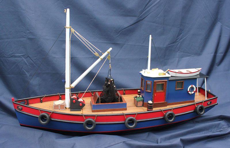

And relax Fishfull Thinking Finished 56 Day Build Of a King Fisher. Ok i did go off plan with some parts but had to work with what I had and could afford.. Total Days of build 56 cost of build including transmitter and receiver under £300..

Excellent work!  That really was scratch building, wasn't it?  Those pipe joints make excellent barrels.
