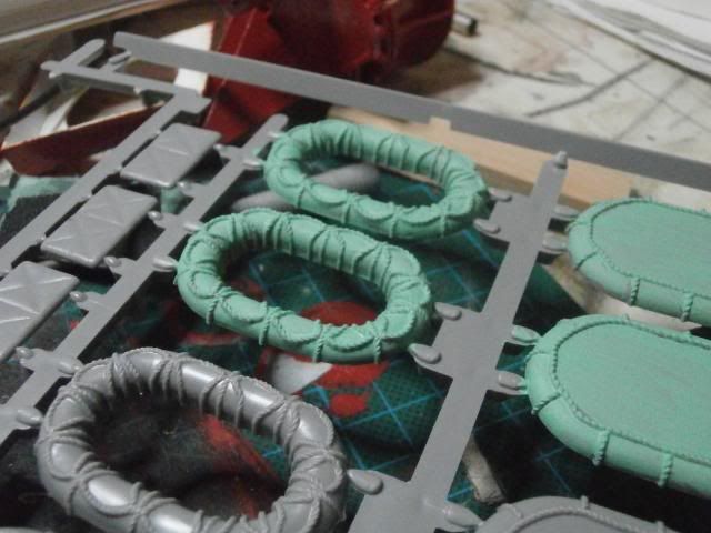

Heres a couple of pics showing the carley floats and ships boats with a first coat of western approaches green

The Carley floats: if it were my boat the rope that is moulded on would be replaced with real cord.

Yes, I didn't think it looked too bad but now I've found some fine chord that will do the job, I think I'll have a go at replacing it :)
