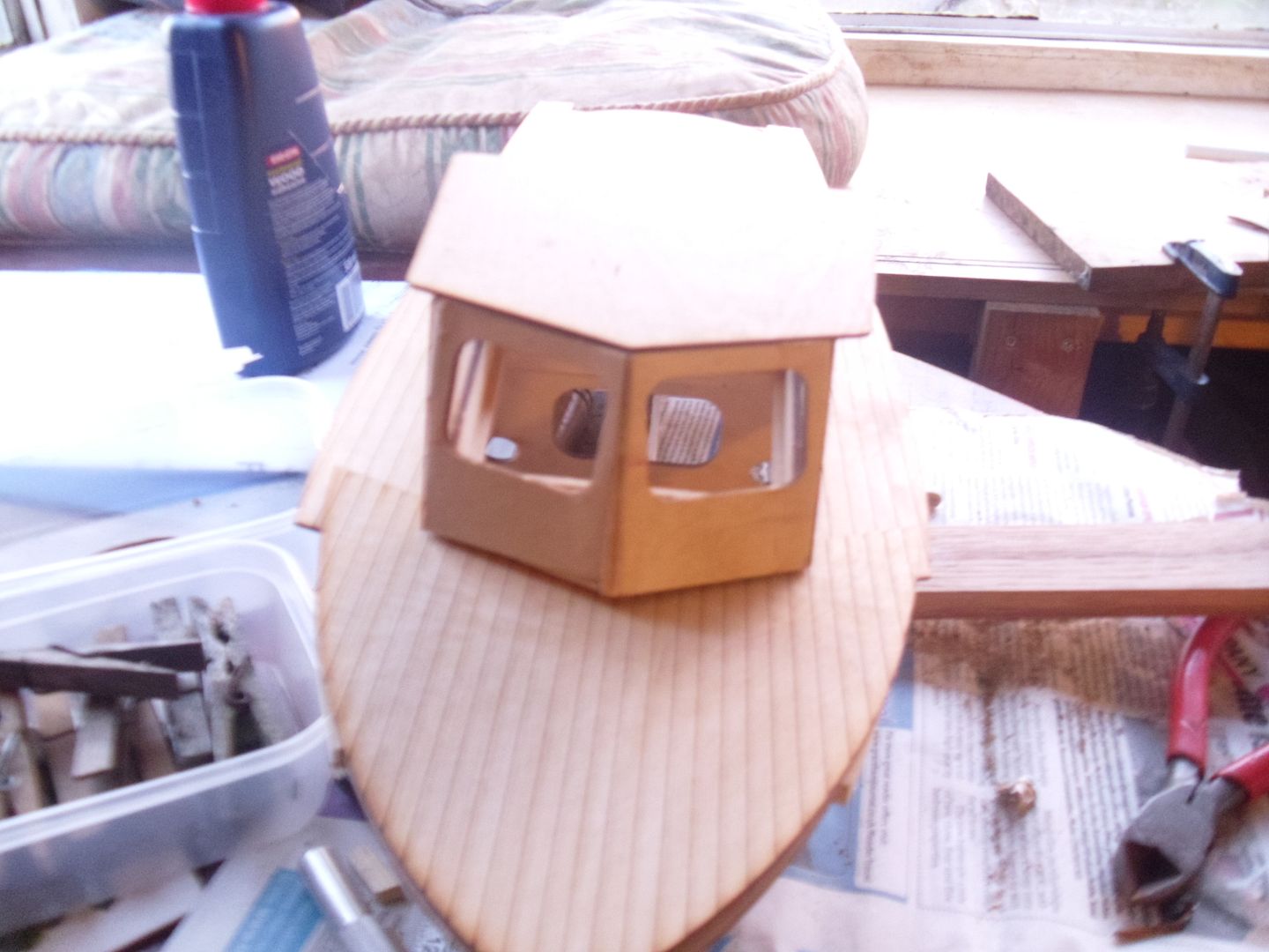

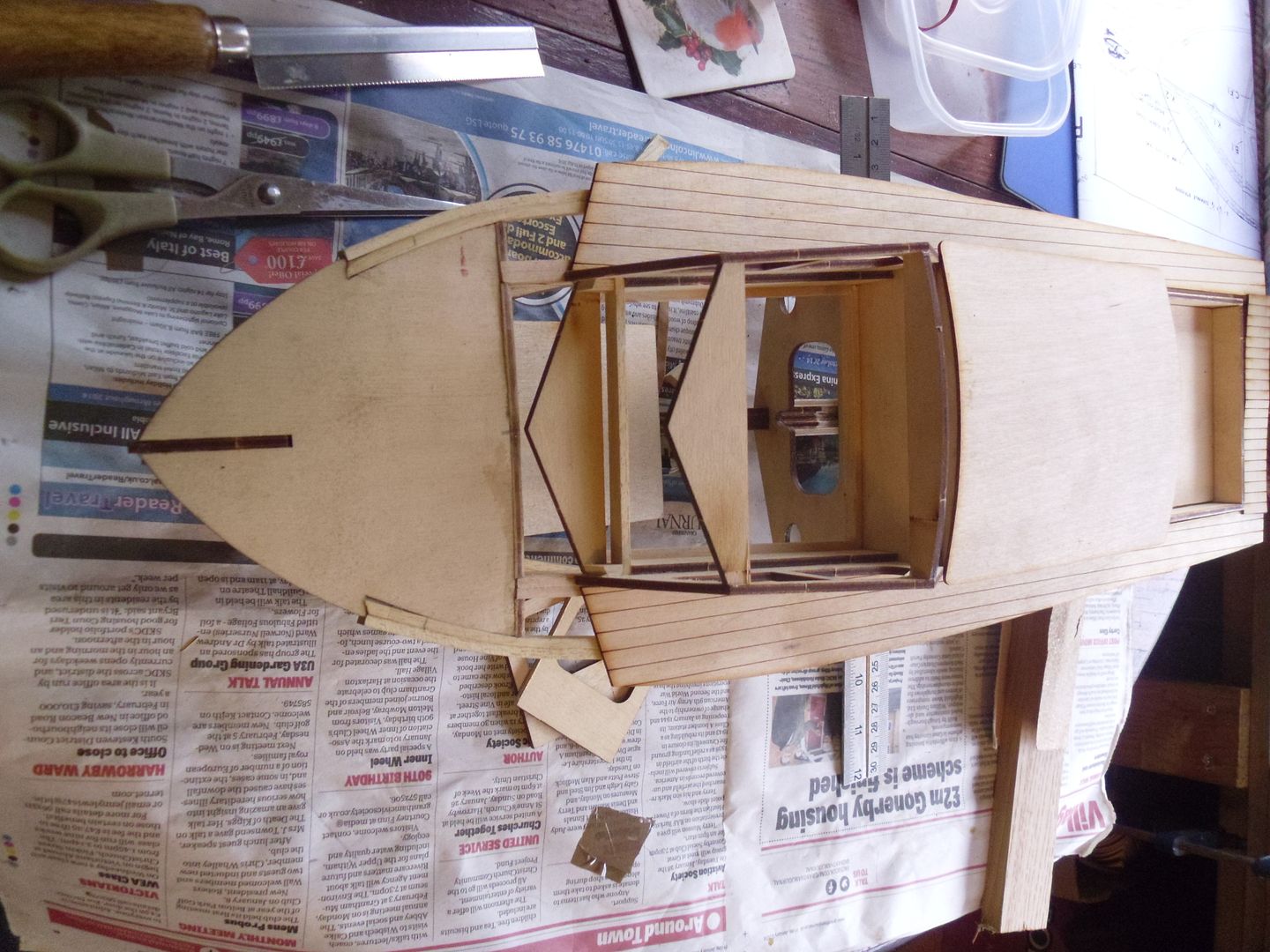

Clearly a large triangular 'gap' each side of the centre of window. My boat had
this part of the deck shaped into a vee so that there was no 'gap'.
Could you build in two triangular false sections here, then the cabin could sit
just into the shape and be supported all along the edges with the gap gone!?
You would need to remove the comb on front edge though to extend the deck.
I have left the cabin rear window open, as per plan
Paul, this was the trickiest bit for me too
Is there not a ply deck yet to fit all round?
N
Yes, side decks are supplied but I am thinking I like the Teak Idea and I do have some to cut up.

Paul,
Wouldn't you put the teak planking on top of the supplied deck pieces?
That's what I did. In fact it was the ply deck that came shaped as a vee
that hid the gap, so my idea of building two triangular pieces wouldn't be necessary.
But, yes a certain amount of adjusting will be required.
N..

Paul,
that hid the gap
N..
Probably not answer below
It wasn't supplied, that front piece of deck for the "Breast Hook" to over plank it would make it un-even.
Thanks for the photy's by the way, they will give me some ideas  :-))
The decks.
The only bits left to fit but alas no front deck <:(
Paul

I think I would make a cardboard template of the complete front shape first, then transfer to a 1/16th piece of ply.
This would then match up with the thickness of ply of the two deck pieces each side of the cabin?
Then plank the whole lot?
Just a thought......
N.

A good thought to, but I have not any spare ply big enough.
Still thinking.................

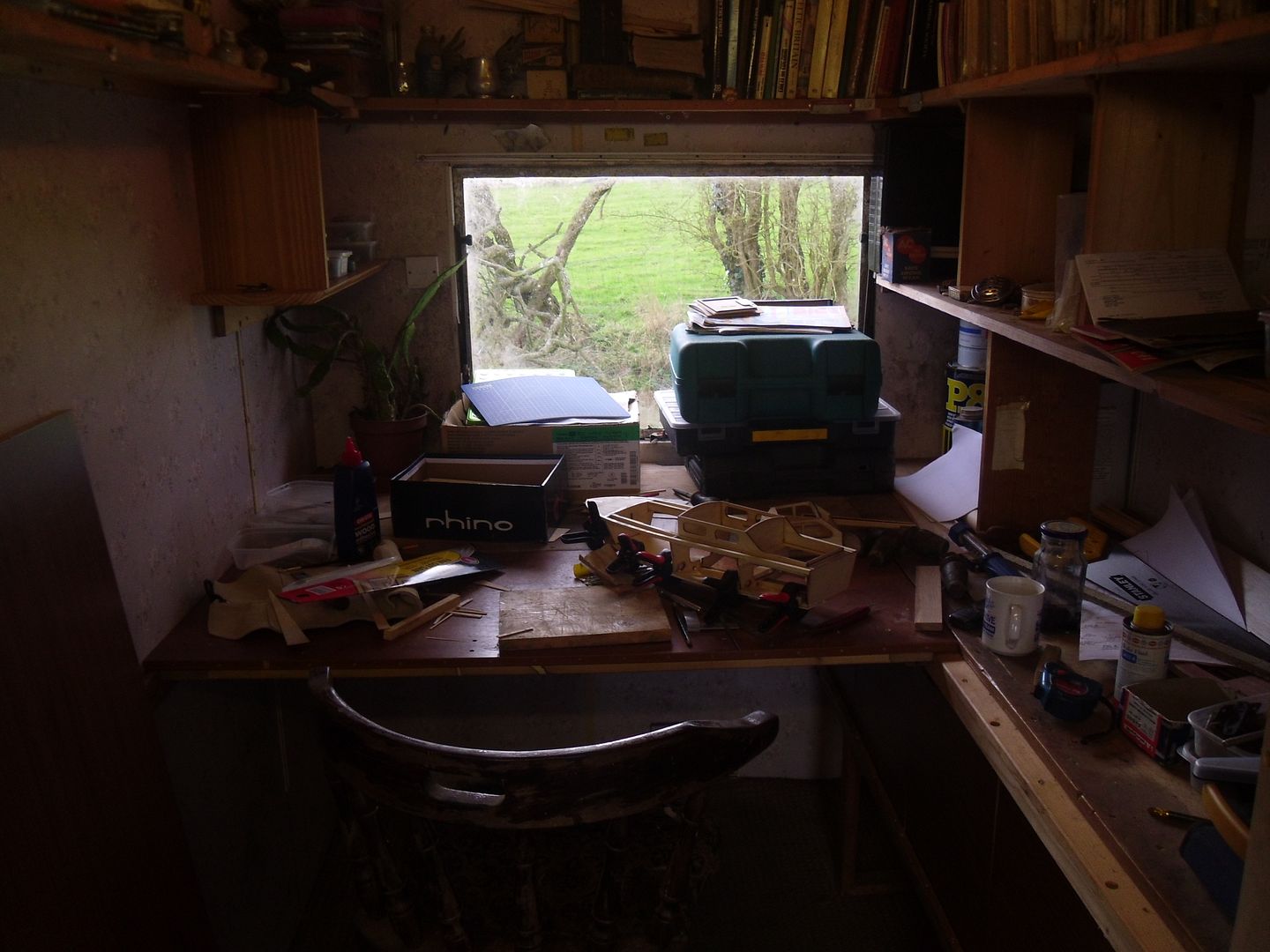

Right, I'm back to it now, I have been sorting out a work area so as to keep things tidy and in one place  :-)) Not quite finished it yet but getting there :-)
The work area.
And todays progress, first bottom skin shaped and fitted, Right or wrong I have put plenty of glue on all joints with a small paint brush.
