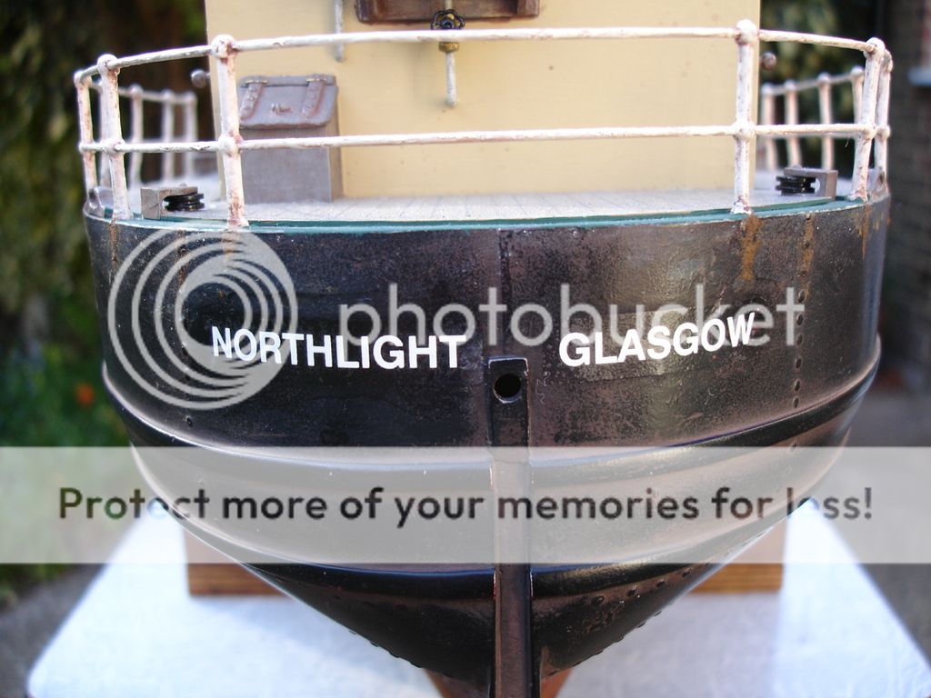

Today, I went for broke and things went well. There is a small amount of "silvering" - which takes the form a micro pattern. I was expecting this as the hull has a semi-matt surface. It was most noticeable on the stern starboard side where the surface was also a bit uneven. I know I should have waited until I had some Microset or Decalfix - but I thought it was worth the try!
Brushing a little meths on (and round the edges) significantly reduced the effect - to the extent that I am satisfied that some "rusty" paint and varnish will hide it altogether.
The pictures tell their own story!
(The whiteish patch at the right hand end of the stern "Northlight" is some surface scuffing, inflicted by me!)

The effect you have got with the end productis very attractive and looks like a name sign applied over old paint or the like and it is just weathering differently to the surrounding hull:O)
I do agree with Arrow about varnishing the model before applying decals IF the carrier film cannot be completly removed for whatever reason. The extra benefit with a good coat of gloss varnish (Future floor polish or whatever it is called these days:O) is great) is that it seals your careful painting under a layer and protects against many of the knocks models suffer.

I haven't quite finished the weathering yet - I wanted to get the decals on first. I thought very seriously about following Duncan's advice and creating gloss patches for them but, as the final coat of varnish will be matt, I thought the outline of such patches might possibly show through. As I was prepared for the decal application to fail, I thought it was worth a try on the current surface.
I am about to try and create some slight traces of rust on the decals and the surrounding areas. The "Scenic Rust" which I have used on the stem and under the anchor port is very difficult to apply thinly, so I will probably use the Humbrol "German red brown" I have used as a wash over the rest of the hull.
