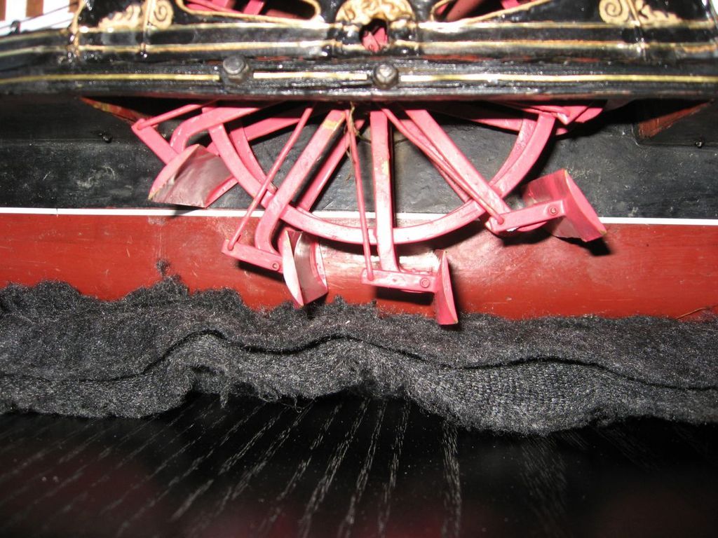

« Reply #5 on: March 01, 2016, 09:06:28 am »
Hi Rick,
Here is a practical model example which works out to be pretty close to what Clark said.
The model is a 48th scale Columba.
HTH
Sandy
